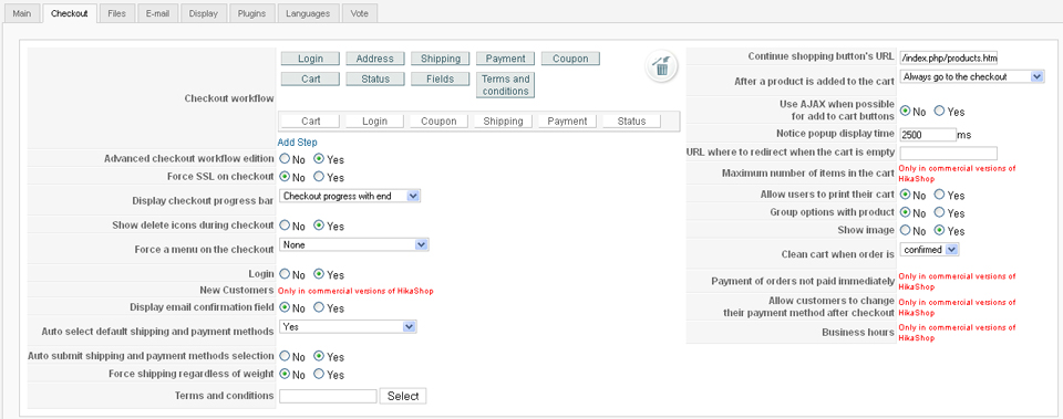

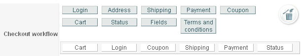

Can you do a screenshot of the Checkout tab of the configuration of HikaShop so that we can see how you configured your checkout ?
  • Posts: 966
  • Thank you received: 11
13 years 11 months ago #61918
Here you go.... Thanks!

I wanted a screenshot of the whole checkout tab, not of the checkout workflow.
  • Posts: 966
13 years 11 months ago #62268
Is this what you are requesting?

I think I know what you mean.
You shop & add items as an unregistered user, and then you go to the checkout and login with your details and you shoot straight to the PayPal login screen?
I asked about this and Nicolas helped me on this too, here is the post:
www.hikashop.com/en/forum/4-how-to/60954...egistered-users.html
You need to create an additional STEP in the process.
I think if you just add one more step and drag the 'Payments' work flow item in there, then, when you login, you will be taken to the checkouts last page before proceeding to the PayPal login page.
