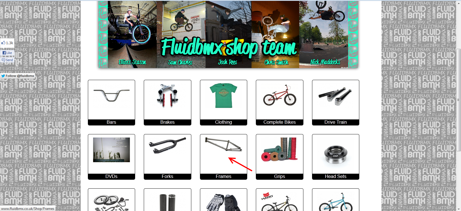

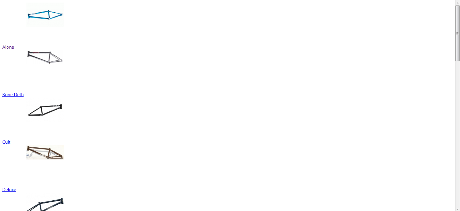

Can't work this out! All pages and category views dispaly as they should except for one category view!! When you click on this particular category the next sub category view loses all CSS. Does anyone have any ideas please?

You do not loose CSS, you have a PHP error which broke the page.
Please check the bottom of your page, an error could be display. If not, you would have to activate the debug mode in Joomla in order to see the PHP error.
At this moment we would be able to help you to fix it.

I've enabled debug and receive the following:
Fatal error: Allowed memory size of 25165824 bytes exhausted (tried to allocate 7200 bytes) in /home/sites/fluidbmx.co.uk/public_html/administrator/components/com_hikashop/helpers/image.php on line 402

All sorted, just set memory limit to 64M in PHP5.ini.
