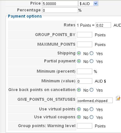

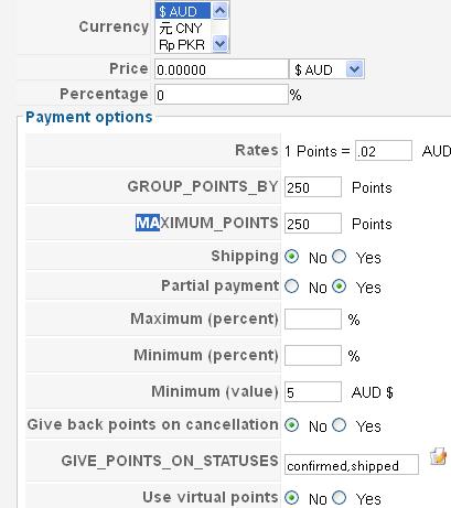

I am using alpha user points plugin in my site.
I want its configuration to set such as when a person purchases a order of 250 AUD or more he will get 5 AUD discount from his order.
But when i set rates in payment options as 1 point=0.02 AUD it doesn't show Pay with Points options in payment method list. Can anyone help me. I am attaching my settings screenshot.
Thanks in advance.

I think you're melting different things.
The earned points are credited to an user once the order is payed. These point can be used later as a payment method to pay a part of the whole cart.
What you configured for now is the rate for payment. It means that if customers want to pay with their point, 1 point will be equal to 0.02 AUD. But they need to already have some points.
If a customer don't have any points, the AlphaUserPoints payment method won't display.
So you cannot make then earn point and spend them at the same time, it's two different things.
You should use discount to give your customers a 5AUD discount when then purchase an order of 250AUD

Thanks for your quick reply. If a user has already earns 250 or more points through his last purchases then only he will get discount of 5 AUD. The problem is that when i set rates in payment options as 1 point=1 AUD the if user had made a total purchase of 250 AUD it says that you have 250 points= 250 AUD.
When the configuration is such as 1 point=1 AUD and user has already more than 250 poins then it displays message " Pay with Points 5.00 AUD
You can pay with points using this payment method
You have 282.00 points (or 282.00 AUD). You can pay the full order with your points (no shipping included), it will cost you 55 points. A coupon will be automatically generated (CAUTION! YOUR POINTS WILL BE REMOVED!)"
But i want 250 points = 5 AUD.
How can i set this in configuration.My settings screenshot is attached in previous post.
Thanks in advance.

I'm not sure I get what you want.
But I think you should set the maximum of point usable to 250. Indeed, if a client has more than 250 points he will be able to use only 250 and thus get a 5AUD discound since 1 point = 0.02AUD.
So what's wrong with the rate 1 point=0.02AUD?
By the way, the price option is the cost of the payment method so I don't think you want to set it to 5AUD
Last edit: 13 years 11 months ago by Eliot.

Sorry for disturbing you again. But my problem is when i set rate 1 point=0.02AUD...It's not working. It is not showing the PAY BY POINTS Option. Also when i put 250 points in group by point option...Its also not working for us. So please help me to come out from this problem how can i configure that user gets $5 against 250 points.
It's working well with rate 1 point=$1...but not working with .02.
Thanks.

I get it. You just need to activate the partial payment option. This option allow you to pay only a part of the final order so it works like a discount.

Thanks for your response. I want to know one more thing. I want the pay with points option to appear only if user has earned more than 250 points earned . How can i configure it.
Thanks in advance.

You should remove the "maximum points" and the minim (value) options.

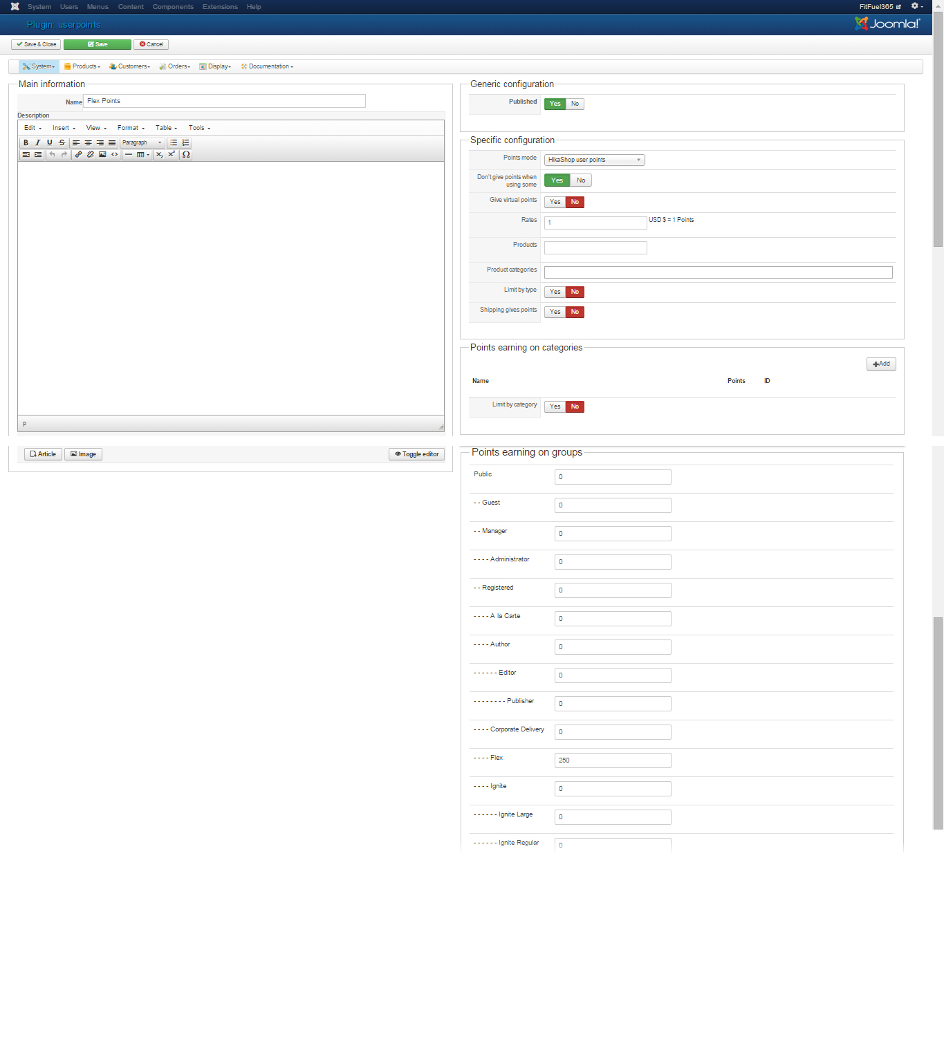

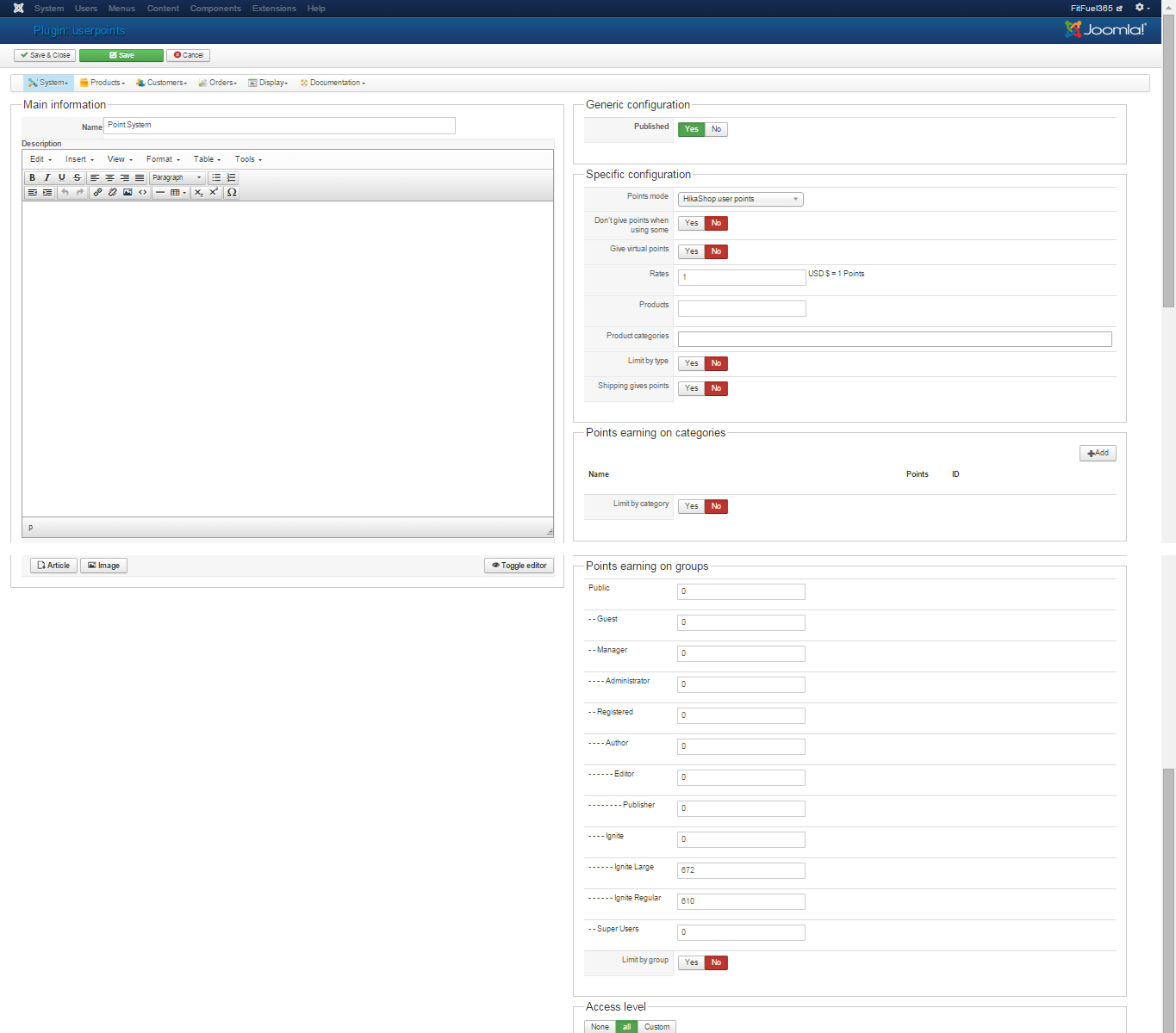

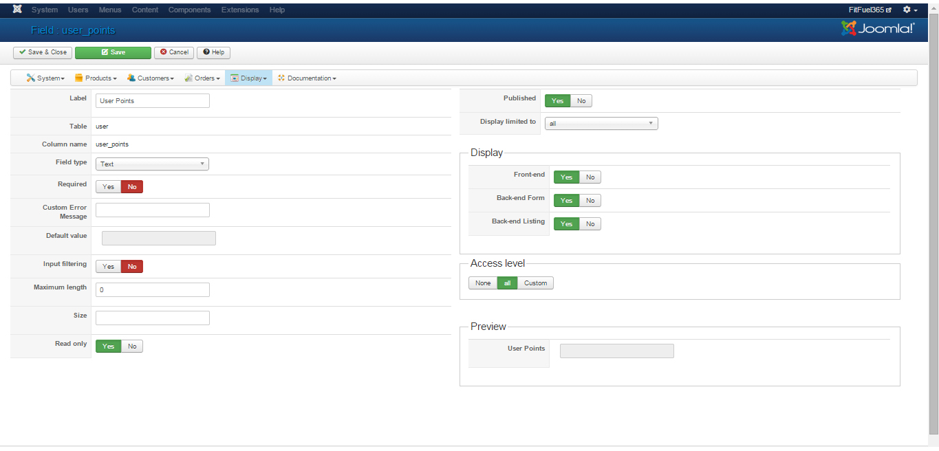

11 years 9 months ago #177574
Hi Jerome,
I am trying to set up the user points, but I haven't managed yet to get this working. Please help me! I have already done the following:
1. I created the following structure of products:i
- Ignite Program (category)
-- Ignite Normal (product)
-- Ignite Large (product)
As soon as a user purchases on of the above products, automatically is included into the corresponding user group (ie Ignite Normal User, Ignite Large User). This is working fine.
2. I created a new user points plugin with the following settings:
a. Points Mode: HikaShop user points
b. Don't give points when using some: No
c. Give virtual points: No
d. On "Points earning on groups" section: Ignite Normal User-->610, Ignite Large User-->672 (I need to assing fixed points per user group, cause points cannot be calculated per product price)
3. Finally, I created a new user custom field for displaying the earnings / remaining points on frontend user profile and on backend as well, as follows:
a. Table: user
b. Field type: Text
c. Read only: Yes
d. Display: all are set to yes
e. Access level: all
The custom field does not display the earned/remaining points neither on profile page nor on backend, so I guess they aren't assigned?
Also, I added the user points payment plugin, but it doesn't appear on the checkout page among the other payment options.
Please, advice!
Thank you,
Dora
Last edit: 11 years 9 months ago by DoraK.

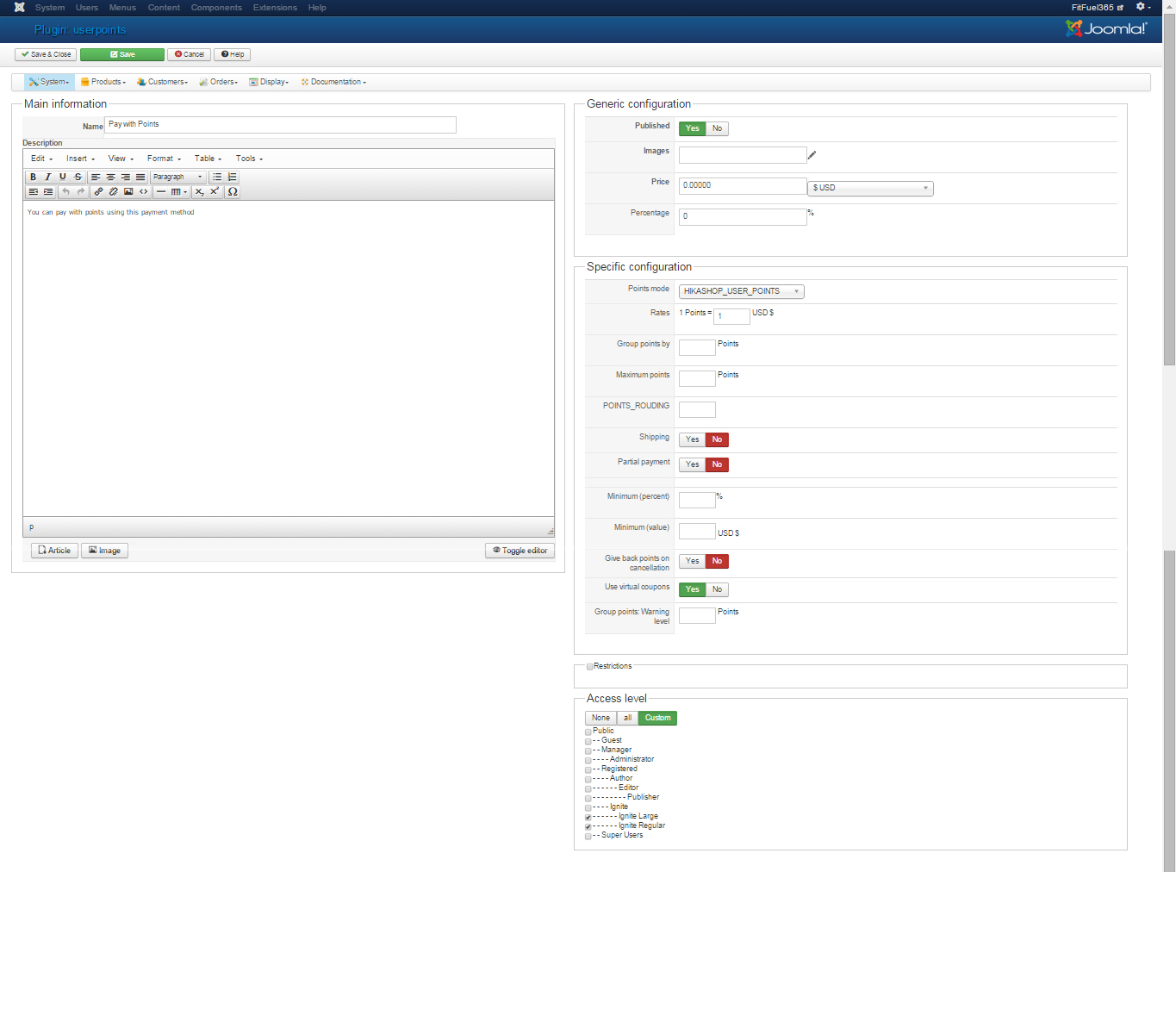

Hi Jerome,
I think it's clear what I need. I want 2 specific user groups (Ignite Large, Ignite Regular) to GAIN points while purchasing and then use these gained points for other purchases in the future as a PAYMENT.
The number of the gained/remaining points should appear on the profile page and on user's backend.
Please, find attached the following screenshots for:
- Plugin
- Payment Plugin
- Custom Field
The documentation file is not clear enough to me. I can't get this working.
Dora
  • Posts: 26381
11 years 9 months ago #177617
Like I said:
The plugin can work in "virtual coupon" mode ; in this mode it does not display as a payment method.
If you want a payment method listed, please deactivate this option.

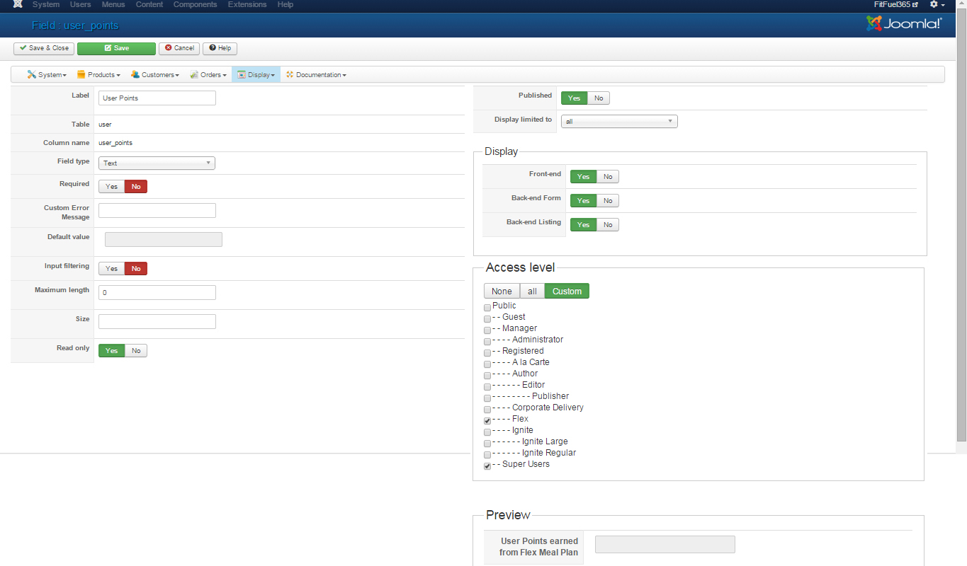

11 years 9 months ago #179362
Hi Jerome,
I tried what you said but still this system is not working. Here are the facts and the current state of the website:
I have a Meal Plan called "Flex Plan" and after confirmation of a purchase of this item, the user is being added to the Flex User Group (the confirmation is manually configured from backend and the user is indeed included to the Flex User Group, so far so good).
What I want is, when the order of the "Flex Plan" is being confirmed and the user is being added to the Flex User Group, the user to immediately earn 250 points (as much as the cost of the "Flex Plan" is). It doesn't seem working. Also, these points should be visible on the profile page of the Flex User and he should be able to choose the "Pay With Points" plugin on future purchases (which currently is not showing at all).
Please, find attached all the screenshots of the configuration, but you can still use the credentials I sent you with pm, when discussing another issue I am having on the same website.
Please, I would like a clear answer that can make the above work.
Dora
  • Posts: 80
11 years 9 months ago #179364
What I have just noticed is that when a user is being assinged to the Flex Users Group (after the confirmation of the Flex Plan order) and the User Points custom field is being added into the profile page of the user all the values of the custom user fields are being removed!!!!
