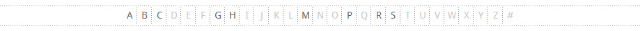

I would like to create an alpha index for filtering products. See the attached image.
What would be the steps needed to create this?

You would need to create a custom field of the table "product" and of the type "dropdown" with one value per letter.
Then, in each product you would have to set that value.
Then, create a filter of the type "list" applied on that custom field and it will display a list of links with one value per value of the custom field on your products listings.
The only thing is that it will have one value per line, so you will need a piece of CSS to have them display on one line. Nothing complicated.
