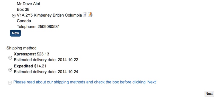

11 years 9 months ago #175694
I followed the instructions from last year and it worked great. I've just upgraded to the latest version and would now like to have the "Next" and "Back" buttons formatted by the template, like the "New" button for addresses (see image, which shows template formatted "New" button and plain "Next" button).
I can change the formatting of "Next" using Firebug by changing type="submit" to type="button", but I can't figure out how do do that permanently within the HikaShop php or css codes.
Thanks.

11 years 9 months ago #175699
You have to add new css properties in the hikashop frontend css file or directly in your template file on the following ids:
#hikashop_checkout_back_button, #hikashop_checkout_next_button{
  /* Your properties */
You can get the template properties thanks to firebug and use it for the given ids.
hikashop.com/support/support/documentati...ize-the-display.html
