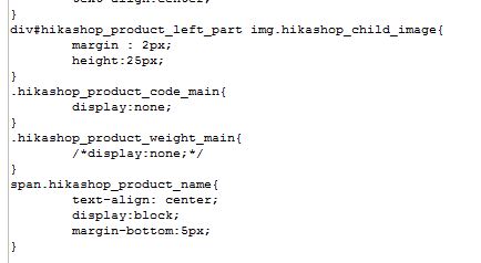

Hi there,
For some reason the 'weight' displays on my product listings, which I do not really want.
I checked 'Frontend CSS' (see image attached). There seems to be two forward slashes and a star which I am guessing should not be there.
Is that breaking the CSS and hence makiking the weight display?

That CSS code can hide the weight.
It's commented out so that it displays the weight by default.
If you don't want the weight to appear, just remove the slashs and the stars.

resolved, thanks

I tried the same but it won't work. I shutdown the shop, the whole system and started again. The weight is shown. (Hika-Shop 1.6.0)
THank you for helping!

solved! Kind of bad programming from my side. Tried to insert a comment wrong. Sorry!
