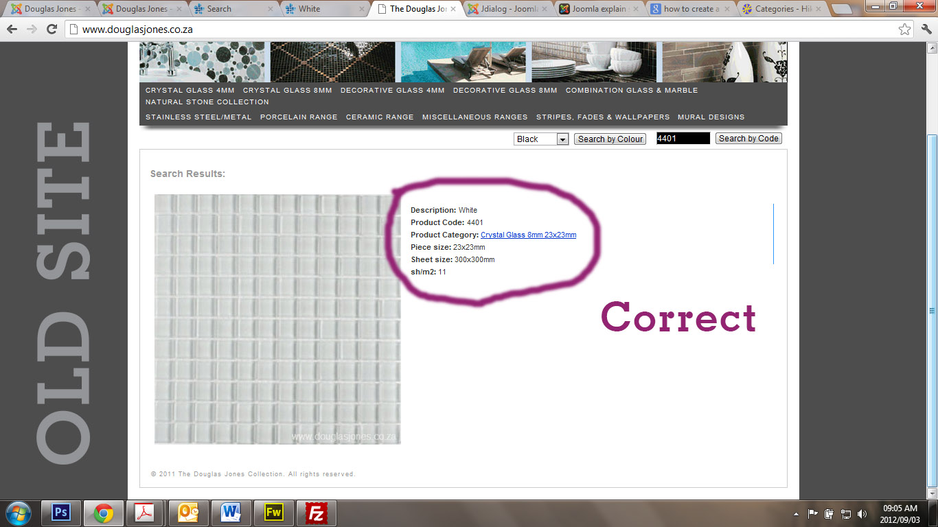

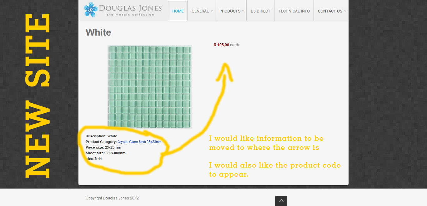

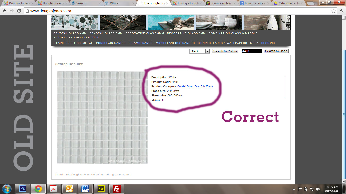

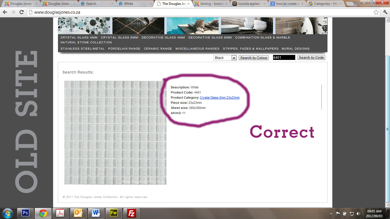

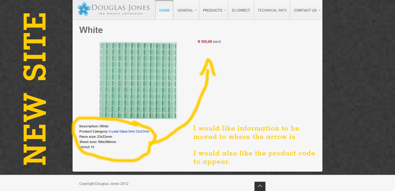

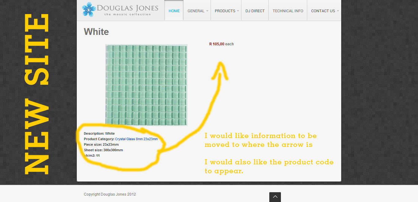

Hi There,
I have searched and I can not find the answer although I believe it must be on your forum somewhere as I cant believe I am the only one to wonder about this:
As per this picture above, this is a picture of the existing site which had its problems, but we have changed over to Hikashop. Only thing is that I cannot work out how to get my specific product details to appear on the right hand side of the image.
Preferably I would like to have the Product Code, The Price, and then the rest of the product information (which I will add from the product article section).
[img size=118168k] www.douglasjones.co.za/downloads/incorrect.jpg [/img]
13 years 11 months ago #63456
I think that you'll just have to:
- Go to "Hikashop->Display->Views"
- Edit the "show_default" file of the "product" view of the front-end template that you are currently using
- Move the code that display your product description to the "hikashop_product_right_part" DIV
Hope this will help you.

Thank you so much for your reply,
This did not work for me. I moved everything I needed into the right side div and nothing happened!
Image description is still below the image :(

You'll just have to move the :
<div id="hikashop_product_description_main" class="hikashop_product_description_main">
    <?php
    echo JHTML::_('content.prepare',preg_replace('#<hr *id="system-readmore" */>#i','',$this->element->product_description));
  </div>
into the "hikashop_product_right_part" DIV.
But you can also give me a temporary back-end access by MP then I'll maybe be able to see where the problem is comming from.
