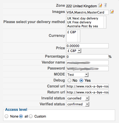

We are going to use sagepay payment gateway on our site. However i have published and configured this payment method with our vendor name and password. I have also set it to test mode and set debug to yes.
When i go through the checkout process and get to the final step the site will not re-direct me to sagepay its simply going to a blank page, with no errors from the debug.
How can i fix this?
Thanks in Advanced
Sean R.
Edit:
I thought a screenshot of the settings could help.
