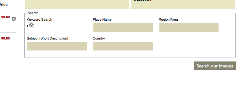

I'm having a bit of an issue with a delete-able field in my library. Basically, when you enter some text into the field, the first letter remains before the cross (see attached). Also, it is possible to change the cross graphic for something else?
Darren

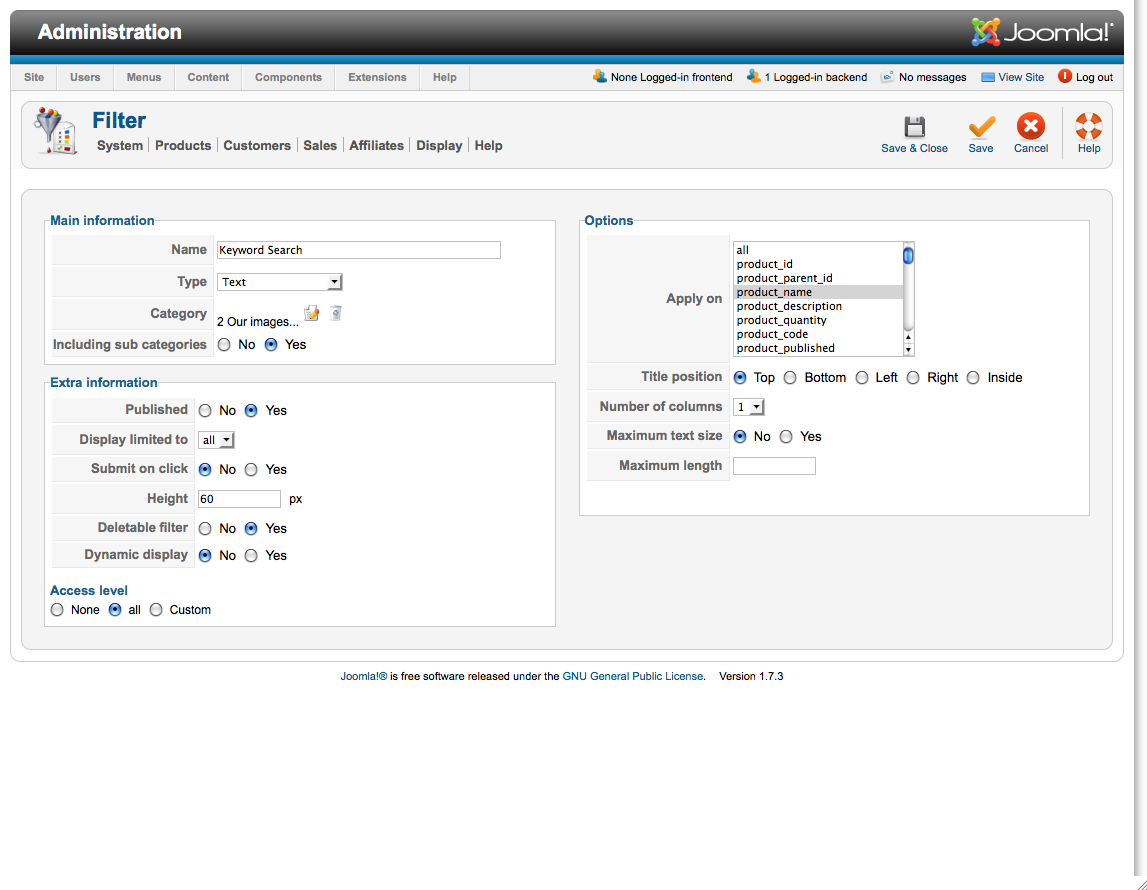

  • Posts: 88
13 years 11 months ago #64027
Hi Eliot,
Here's the config:

It's working well there. Could you give me a link so I can try by myself?
  • Posts: 88
13 years 11 months ago #64035
