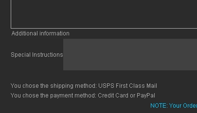

Good Morning,
I have added a custom field in the order process called Special Instructions and would like to add some space between the label "Special Instructions" and the textarea box. I can achieve what I want by using Firebug to change class="hikashop_contentpane", but can't find that class in the CSS file. How can I change the formatting of custom fields?

15 years 6 months ago #6691
You can add the CSS below in the config under the tab display in your front end CSS file:
#hikashop_checkout_additional_info label { margin-right: 10px; }

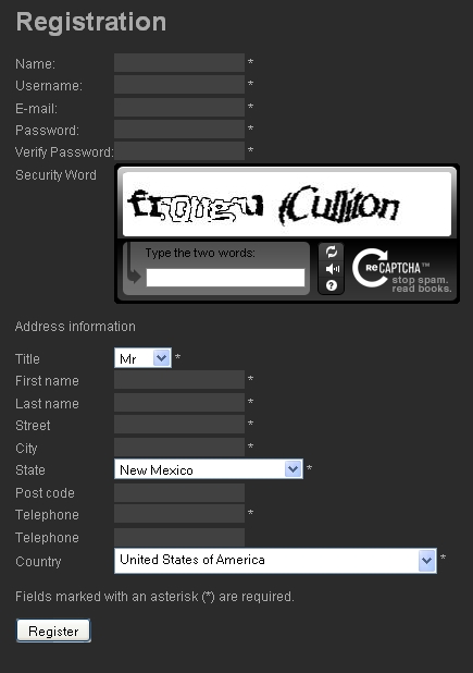

Thanks for that, how about moving the Security Word box down to just above the Register button.

15 years 6 months ago #6695
That's actually not possible. You can either have it under the email field or the verify password field. There is no option in the plugin to display it below the country field.

15 years 6 months ago #6698
You can always edit the code of the plugin and make it work for your needs. It's in the file plugins/system/recaptcha.php ;)
