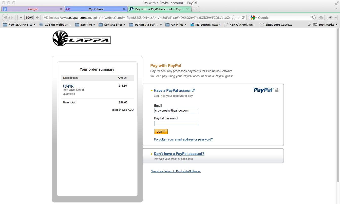

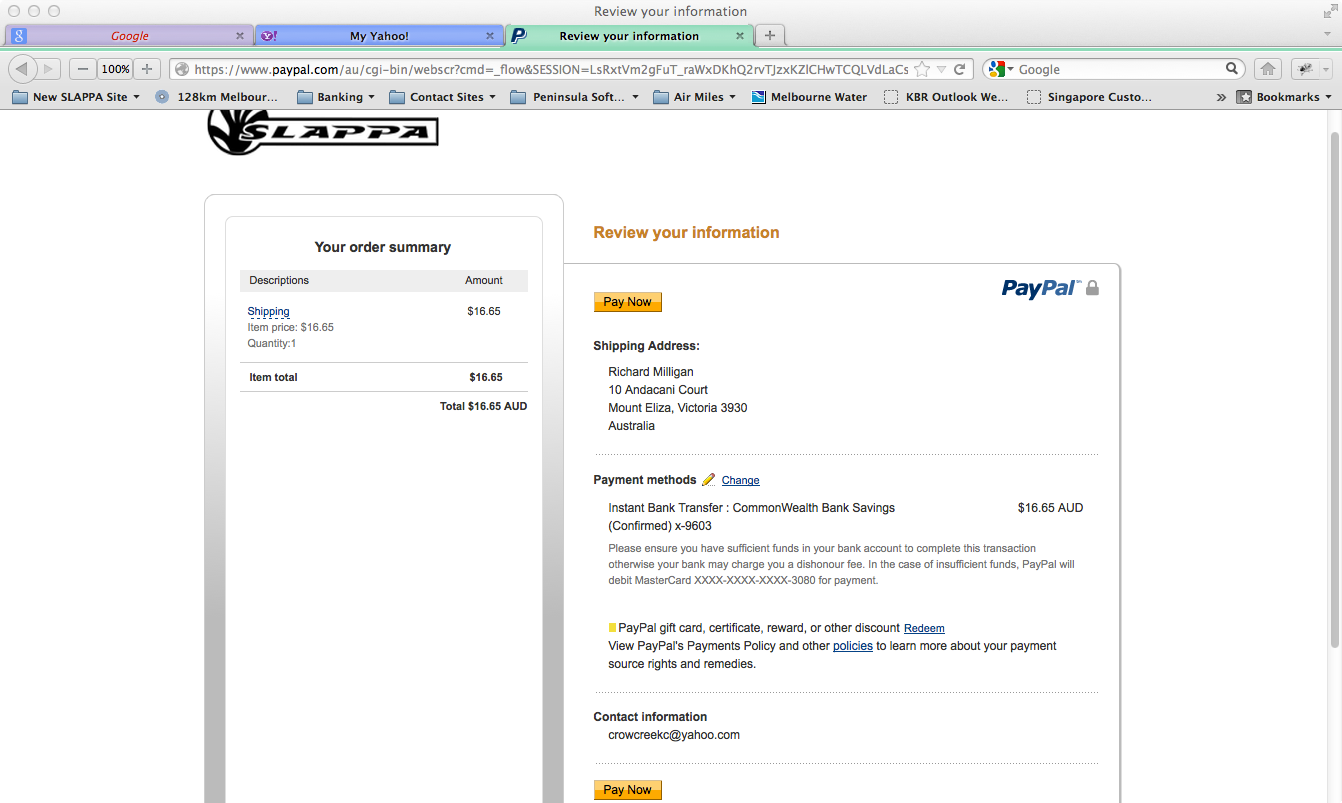

Setup the PayPal plugin for our site. When placing an order, it does forward to PayPal for completion, but only the shipping cost is displayed in the Order Summary and the only cost charged for the order. The product cost is not part of the invoice.

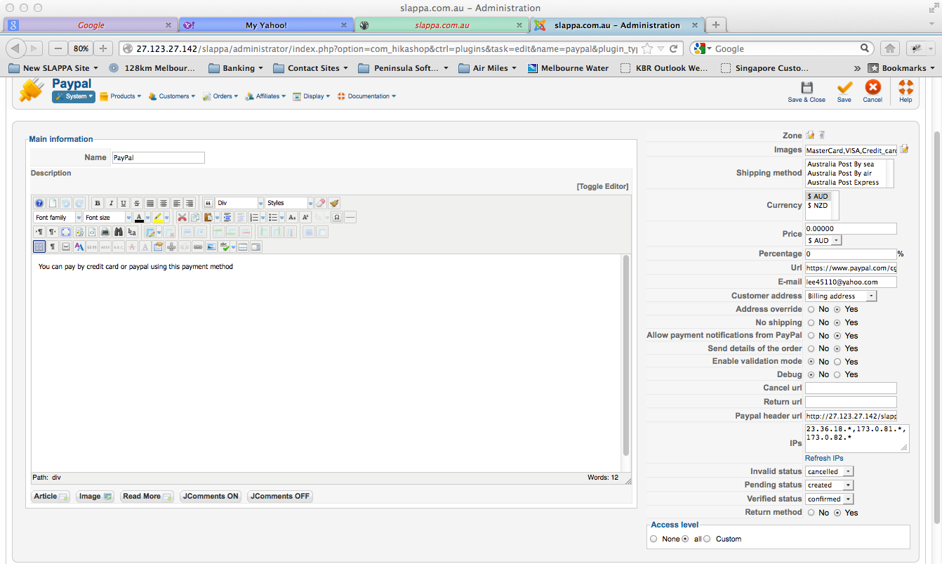

I think that you should use the "Send details of the order" option through "Hikashop->System->Configuration->Payment methods->'HikaShop Paypal payment plugin'".
Hope this will help you.

13 years 10 months ago #67458
I tried this and no good. I have disabled and re-enabled the plug-in and tried changing the plugin settings to see if any will work. The only issue is the sending of the correct invoice amount. It only sends the shipping still.

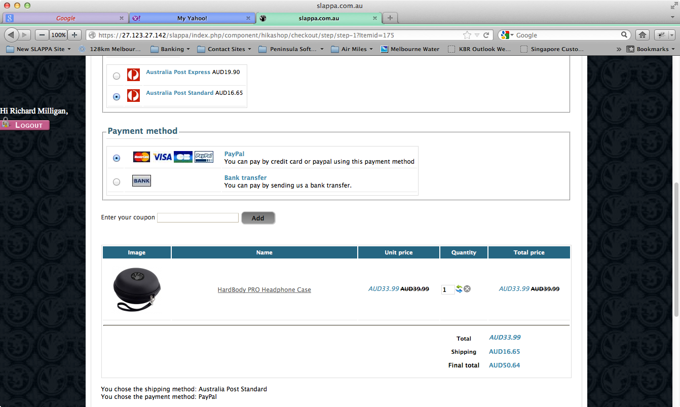

13 years 10 months ago #67534
Can you give me screenshots of your cart and of what is send to Paypal ?

  • Posts: 33
13 years 10 months ago #67559
Here are the screenshots including the plugin settings

  • Posts: 86052
  • Thank you received: 14180
13 years 10 months ago #67648
As mohamed wanted to say, if you turn off the "send order details" option of the plugin it should work.
