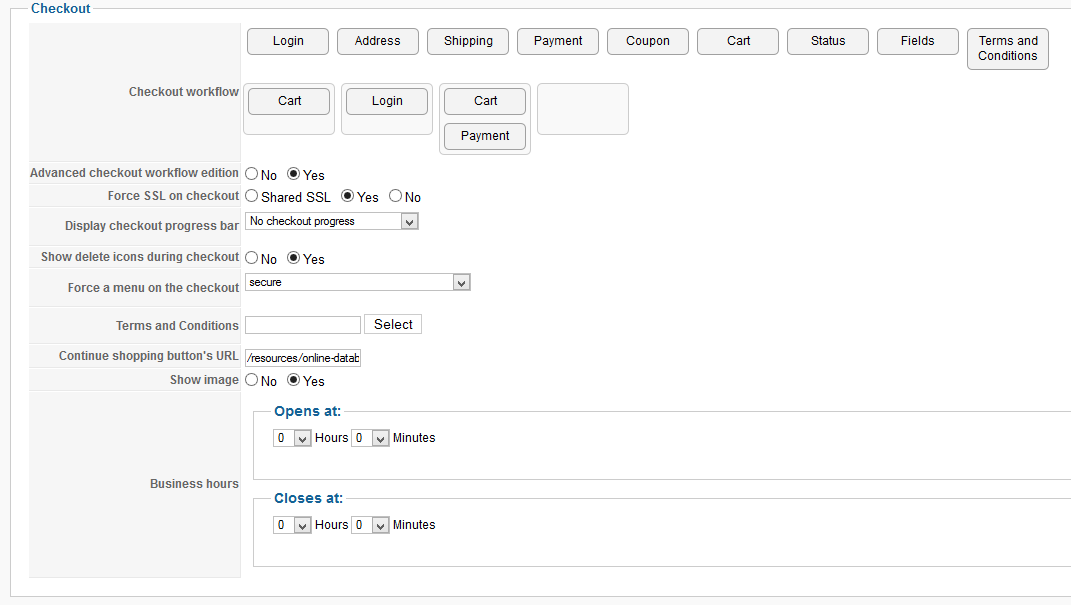

  • Posts: 35
11 years 11 months ago #168881
Hi Xavier, It's v2.2.0 and the workflow is attached.
11 years 11 months ago #168941
Thanks to update your HikaShop versionn the latest one is 2.3.2 and this bug has been corrected. ;)
Don't forget to make backup before updating.
