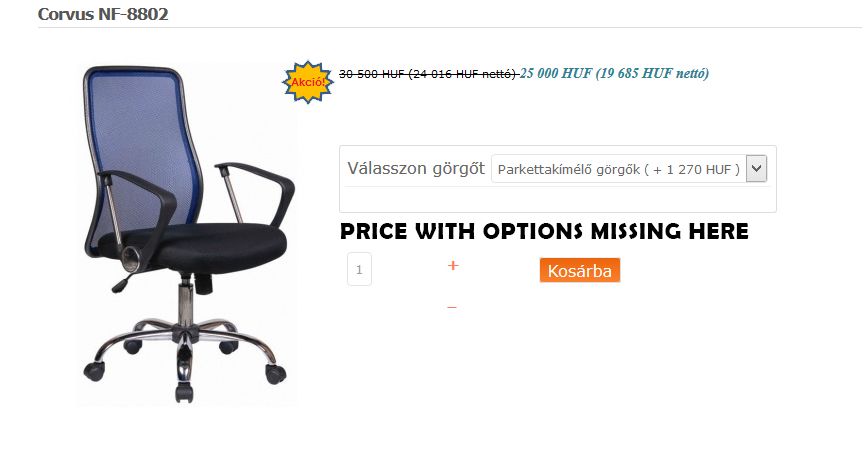

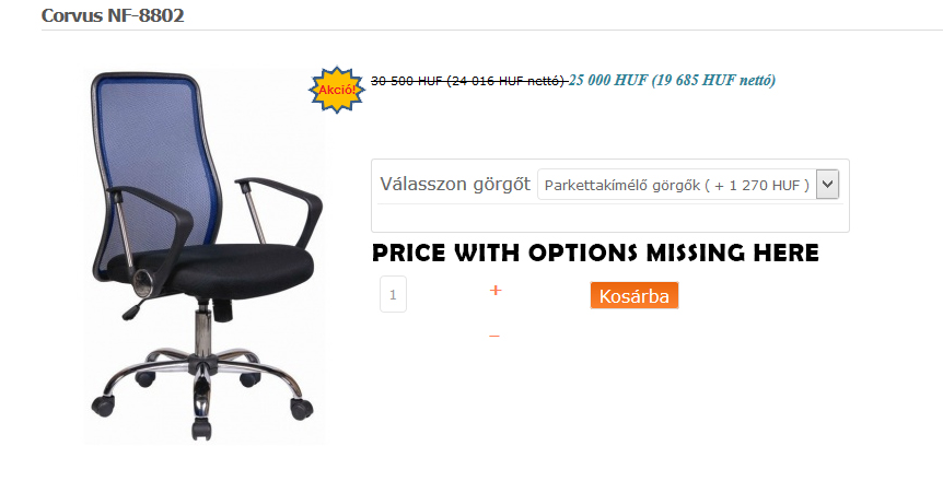

  • Posts: 4
11 years 1 hour ago #211427
Hello Mohamed,
thank you for your answer.
Please kindly visit http://irodaszekfutar.hu/termekek/forgoszekek/product/693-corvus-nf-8802 and you can see if I add an option from dropdown, the price is not changing at all and / or the price with options line is missing.
Can you please let us know which codesnippet has to be modified in "show_default" to see both PRICE and PRICE WITH OPTIONS?
Thanks a lot in advance!
  • Posts: 4
11 years 19 minutes ago #211437
Hi there,
we succesfully updated HikaShop to the latest version and it works fine now.
Thanks!
