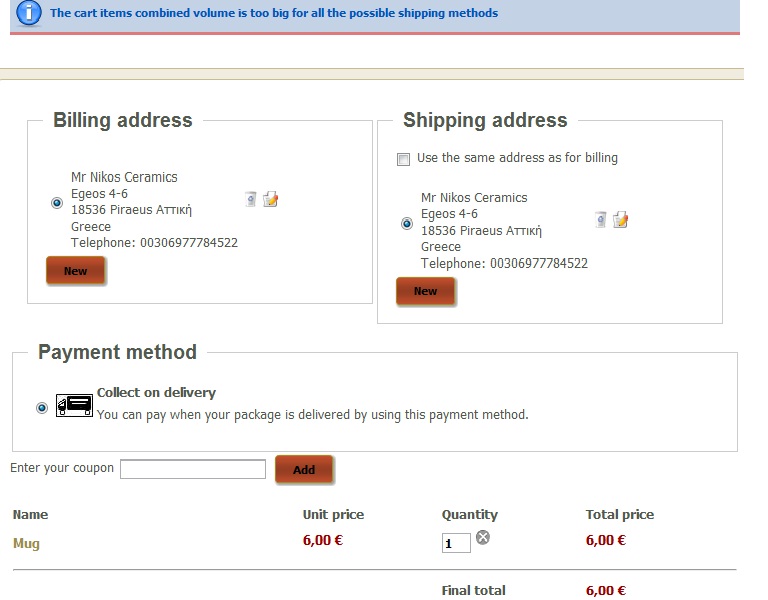

I'm having the same problem.I've tried to configure according to the threat but no effect :(

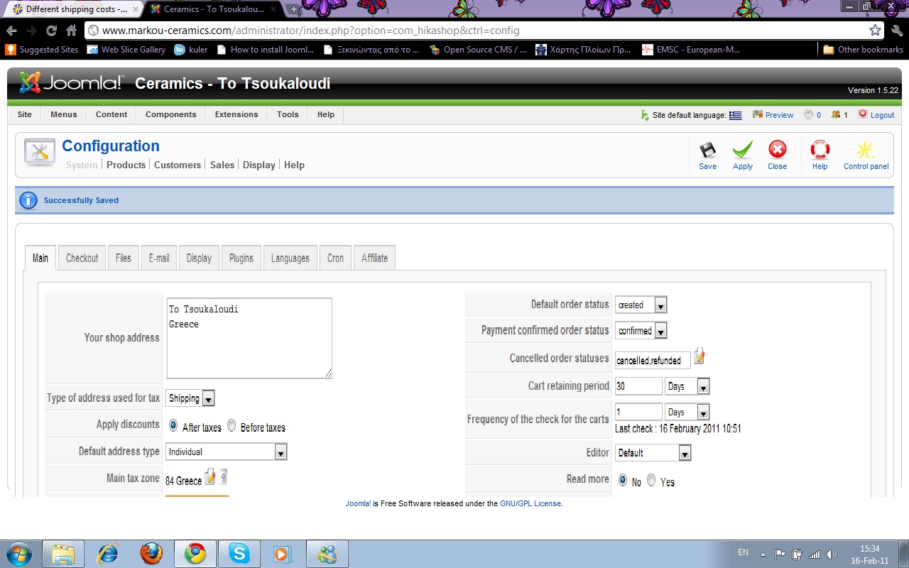

  • Posts: 86042
  • Thank you received: 14175
15 years 5 months ago #8232

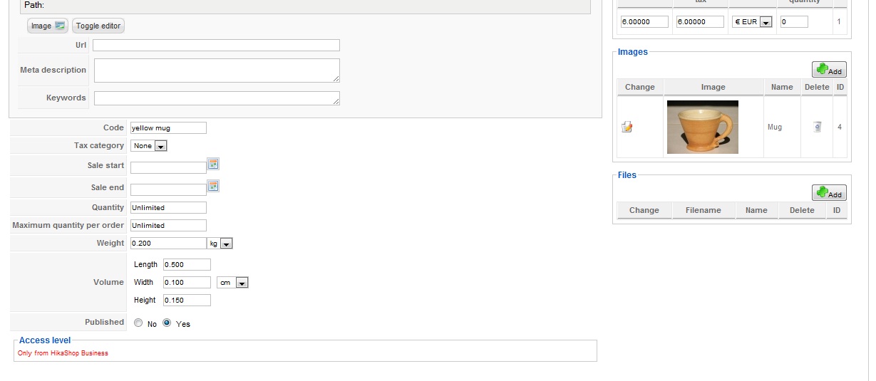

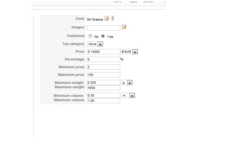

Could you post screenshots of your settings ? The config main tab, the listing of manual shipping methods plugin, your product's options, your checkout on the front end.

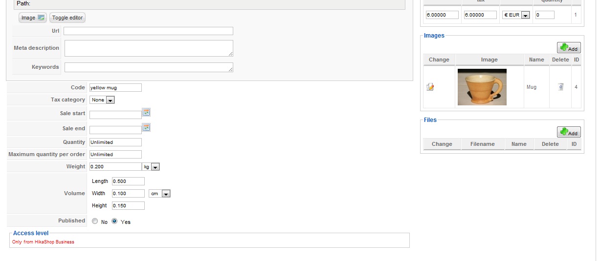

  • Posts: 97
15 years 5 months ago #8237
Life is nice but is with somebody else

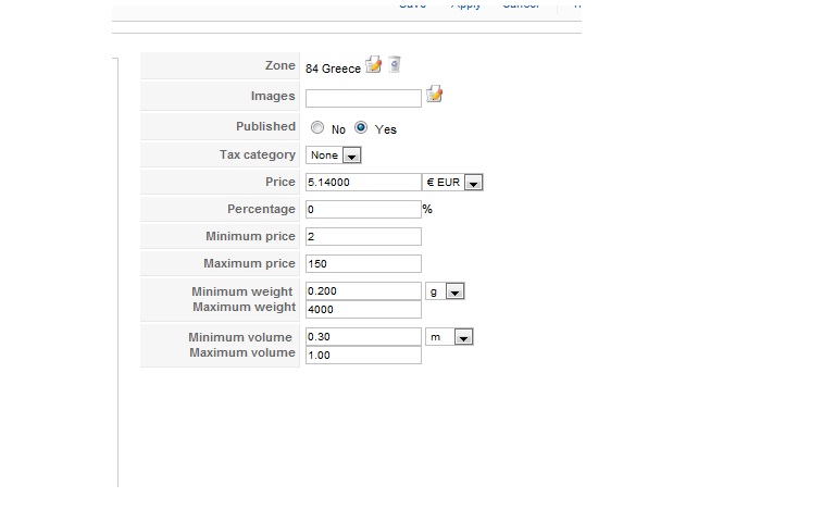

  • Posts: 97
15 years 5 months ago #8238

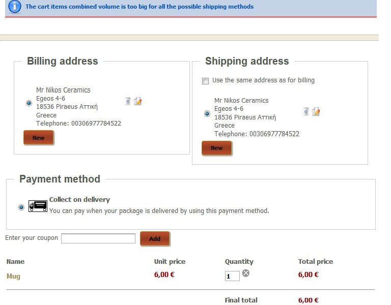

  • Posts: 97
15 years 5 months ago #8239
  • Posts: 97
15 years 5 months ago #8240
  • Posts: 86042
15 years 5 months ago #8241
your shipping method has a volume min limit of 0.30m^3 and a volume max limit of 1m^3
Your product has a volume of 0.005*0.0015*0.001 m^3 which is lower than the 0.30m^3 minimum limit of your shipping method. Thus, you have that error message on the checkout.
  • Posts: 97
15 years 5 months ago #8242
Sorry I'v thought that was meter and not m3... ouf i think is a bit difficult :(

  • Posts: 86042
15 years 5 months ago #8245
Try to remove the minimum volume limit in your shipping method or set a really low one.
  • Posts: 97
15 years 5 months ago #8247
worked!!!!!!!!! :cheer:
