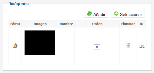

  • Posts: 104
13 years 6 months ago #89699
I'm trying to use watermark but when I upload the product image I only can see a black square.
Why?

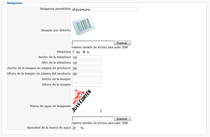

13 years 6 months ago #89797
Could you give us a screenshot of your image configuration ?
What type of image are you adding ?
  • Posts: 104
13 years 6 months ago #89806
Yes, of course
This is what I see.
EDIT: I'm using joomla 2.5.9 and hikashop 2.1.0 business
Last edit: 13 years 6 months ago by dyvymtvar.
  • Posts: 26381
13 years 6 months ago #89896
Which is the format of your watermark image ?
I made some tests and if your image is a png you should let the opacity to 100%, at this moment, the transparency would be used correctly.
The PNG should not be compressed with special "encoding" in order to be properly open by PHP GD.
