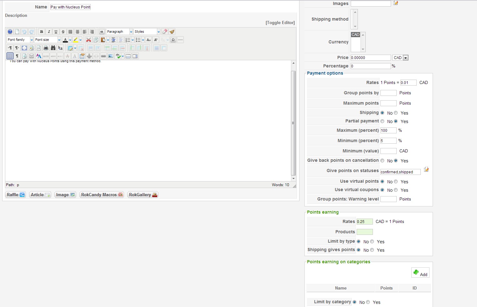

How did you configure the AUP plugin ? Could you post a screenshot please ?
  • Posts: 121
  • Thank you received: 7
13 years 11 months ago #70095
Here is the screenshot
