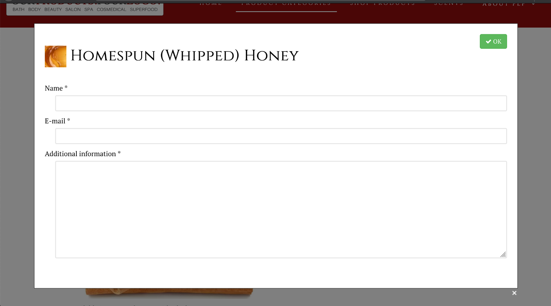

5 years 2 months ago #332612
The modal solution didn't work with the template we're currently working with either but we found that we could simply add the following to the code Nicolas provided previously and the contact button then uses the same styling already loaded for the product image modals.
<a rel="shadowbox" href ... and so forth

5 years 2 months ago #332623
Another alternative, when you don't use shadowbox for the image popup could be to use a modals ( extensions.joomla.org/extension/modals/ ) tag to generate the popup.
So it would be:
{modal <?php echo hikashop_completeLink('product&task=contact&tmpl=component&cid=' . (int)$this->element->product_id . $this->url_itemid); ?>}<?php echo JText::_('CONTACT_US_FOR_INFO'); ?>{/modal}
