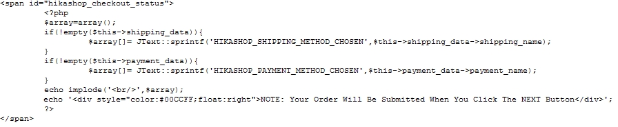

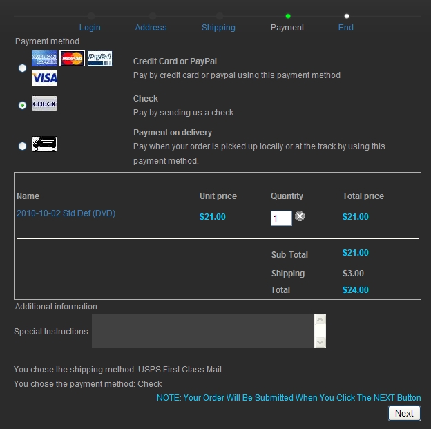

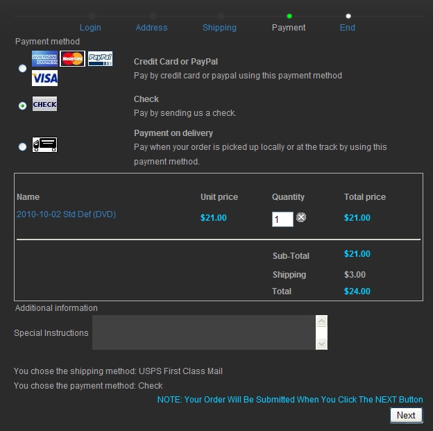

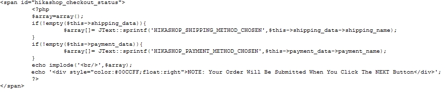

I was also concerned about the abrupt end of the checkout process with no indication that the next click of the NEXT button would submit the order. My solution, while not very elegant and does not address multi-language sites, was to add a line to the file Status of view Checkout.
This solution might not work for every case, but works for me because I have altered the checkout workflow and only put the Status view in the final step.

15 years 6 months ago #7230
My checkout workflow is:
login,address,shipping_cart,payment_cart_fields_status_confirm,end
The line added to the file Status of view Checkout is the last one in the code image above that begins with echo.
I had to edit the post a couple of times because
wasn't working so I created an image of the code instead.
Ed
  • Posts: 242
15 years 6 months ago #7231
Sorry, I forgot to answer your last question.
The Note appears on all Payment steps no matter what form of payment is selected.
Ed

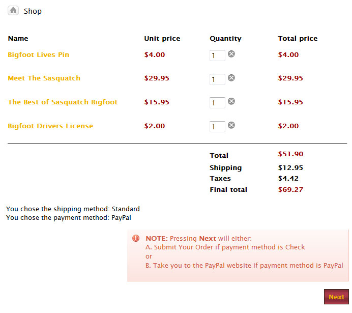

  • Posts: 26
15 years 6 months ago #7245
Thanks to your help I setup a nice looking notification using a modified checkout workflow
Checkout Workflow:
login_address_shipping_payment_cart,confirm_cart_status_fields,end
This workflow gives the customer all the info on step 1 to see shipping and payment options as well as to see a total before logging in or going through multiple steps. It also avoids the problem of having the Address on the same page as the status.
Step 2 shows the cart and the status along with the NOTE which I was able to nicely style and give a bit more info on the two payment options and what happens next
This works nicely. Thanks again!
