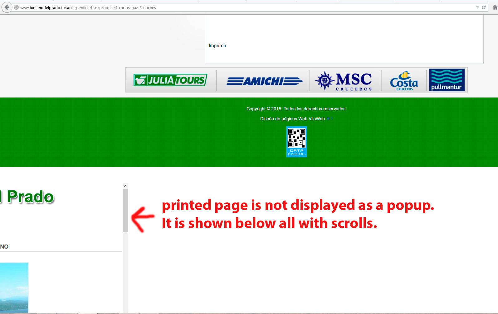

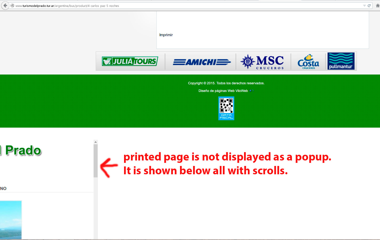

10 years 11 months ago #207328
Hello. The above code worked perfectly today. I just upgraded to HikaShop Starter: 2.5.0 and no longer works.
Printed page is not displayed as a popup. It is shown below all with scrolls (I attach capture).
I would appreciate much I indicated that I edited to function properly again. Thank You.
Last edit: 10 years 11 months ago by vilo.
  • Posts: 85786
  • Thank you received: 14079
10 years 11 months ago #207329
This issue indicates that your template is not compatible with the bootstrap popups system. Fixing the template is a solution but you can simply modify the "popup mode" setting of the Hikashop configuration to "mootools" and that should circumvent the problem.
  • Posts: 86
10 years 11 months ago #207422
Nicolas thank you very much! It worked perfectly!
