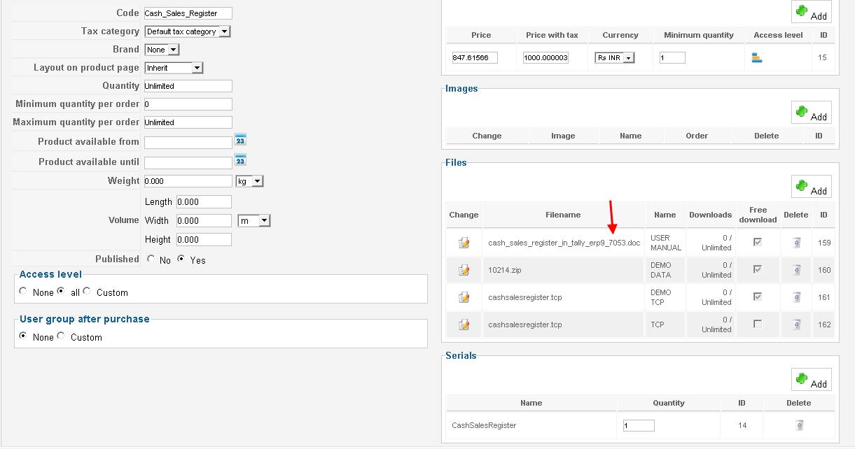

While uploading a file, say some "xxx.doc"; an underscore and a number is being appended automatically after the upload that it looks like some "xxx_1234.doc".
Please find the attached screenshot.
What could be the problem?
Manjesh.
Last edit: 13 years 9 months ago by manjeshmohan.
  • Posts: 26381
13 years 9 months ago #73164
It means that the file "xxx.doc" already exists.
HikaShop does not overwrite existing files so it appends a random number in order to have a non existing filename.
The following user(s) said Thank You: manjeshmohan

I did not noticed that till now. Will check that?
But I've edited the uploaded file name by removing the underscore and number manually and saved it.
Will there be any problem?
  • Posts: 26381
13 years 9 months ago #73169
It would use the other file.
And if the file is too old (not the right "version"), you can manually update it using FTP.
In the same time, you could remove the "xxx_1234.doc" which is no more used :)
