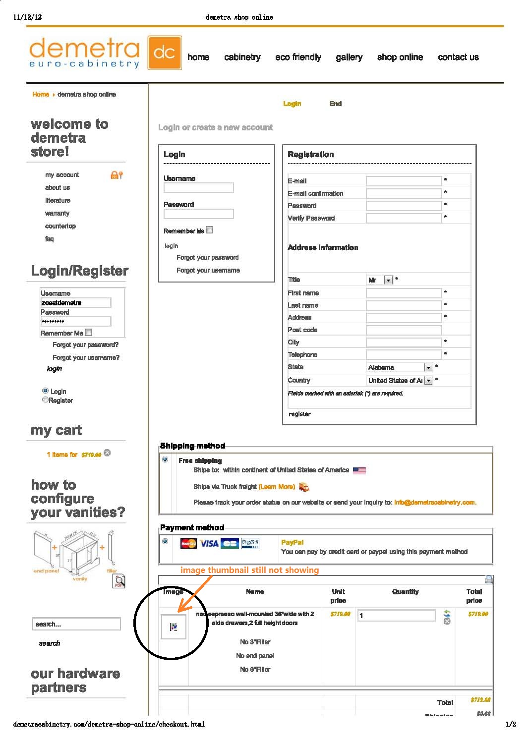

Please take a look at the attached page. You can view the actual webpage: demetracabinetry.com/demetra-shop-online/checkout.html

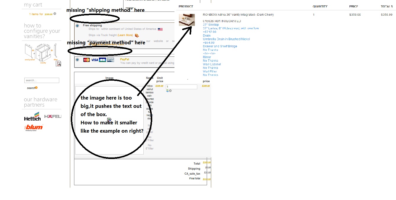

2 problems on the checkout page:
1.Shipping method / payment method : title is missing
2.Image is too big and it pushes the text out of the boarder line.
I am new at Hikashop and green with CSS codes, can you advise me how to solve above problems more specificly? Thank you!

You can add that CSS to display the titles:
#hikashop_checkout_page legend {
color: black !important;
And for the images you can add that CSS:
.hikashop_cart_product_image_thumb img{
height: 40px !important;

For the problem 1, firstly I didn't edit the "Cart" file of the "Checkout" view of the front-end template. The weird thing is that it didn't show on the computer screen but when I print it (to PDF) it appears in light grey color. See attached.
For the CSS coding you instructed, I don't know which file to use for adding those on? Is there any specific place that i should add on or just add on the very end?

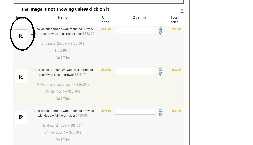

However, another problem regarding the image, see attached, the image is not showing there unless you click on it. How to make it showing with a small thumbnail?
Thanks!

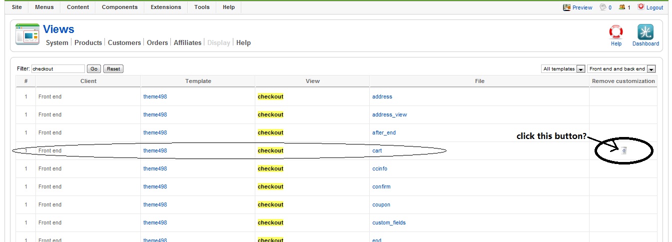

I think that the problem is coming from the fact that you changed the "Cart" file of the "checkout" view of the front-end template that you are currently using.
If that's the case :
- Could you save your modification in another file and then revert your changes through the "delete" button in front of your "Cart" file ("Hikashop->Display->Views") ?

I don't think I changed the "CART" file of the "checkout" view of the front-end template, If I did, that must be by accident.
Before I do anything, to avoid messing up other stuff, I want to make sure I understand you correctly. Please see attached, do you mean I can click the "delete"(remove customization) button as circled out there?
  • Posts: 86181
13 years 10 months ago #75539
Yes, that's indeed what Mohamed meant.
If you see the delete button, it means that you had edited it previously.

  • Posts: 86181
13 years 10 months ago #76166
Then it means that either you're not using the latest version of HikaShop or that the folder media/com_hikashop/upload is not writable (in that case, you should check its permissions via FTP).
13 years 10 months ago #76167
Your problem come from the thumbnails, I think that you had changed the thumbnail size parameters, so HikaShop is searching the images in the folder with the new dimensions.
Try to remove and add the images in the product edition page in HikaShop. This will generate the thumbnails with the good size, and then they will be displayed fine.
