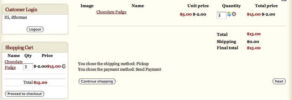

I have set up an auto load discount so that when people purchase a container of fudge, they get a $2 discount for each container they order ($7.00 regular price, $5.00 with the discount.) They can order any quantity. The discount is working fine for purchase of any quantity.
I will pose my question assuming a person has 3 containers of fudge in their cart, the Unit Price column shows the price as $5.00 in red and -$2.00 in black. Then in the Total Price column, it shows $15.00 in red and still -$2.00 in black. I think it will confuse people, because I think it should show the total discount ($6.00). Same situation in the cart module on the left.
See attached screen shot.
Is there a way to either remove the discount listed or to make it reflect the total of the discount?

You can add that CSS in the front end CSS file of HikaShop via the Display tab of the configuration to remove the display of that discount there:
.hikashop_cart_module_product_price_value .hikashop_product_discount, .hikashop_cart_product_total_value .hikashop_product_discount{
display:none;

So specifically, which file will I add that line? The discount also shows on the product page, which I would like removed also.

There is only one front end CSS file of HikaShop that you can edit via the Display tab of the configuration:
www.hikashop.com/en/support/documentatio...shop-config.html#css
For the product page, you can simply change the "show discounted price" option of the Display tab of the configuration.

Thank you very much! I was trying to find the file through the Display Drop-down Menu, but I overlooked the Display Tab. The solutions are exactly what I was looking for.
