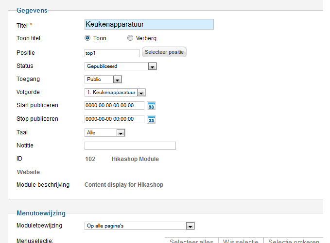

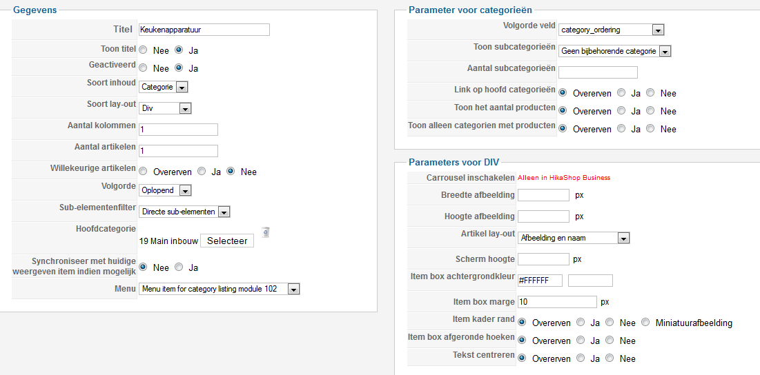

13 years 9 months ago #75180
How have you got created these modules ? Can you give us a screenshot of your modules configuration ?
To do that, and I think that you have done this like that, you have to create new modules with the type products listing or category listing, then assign it to a position in the joomla options and allow the display where you want.
  • Posts: 43
13 years 9 months ago #75204
here are the screenshots...
I make a new module (hkashop content) then i set the hikashop options.
hope this helps.

13 years 9 months ago #76870
In the module's "menu" option, please make sure that you select the menu item with the id 121.
  • Posts: 43
13 years 8 months ago #77733
i cant select that option only 104 and 106.
i have set it to menu_item_root and it works now too
