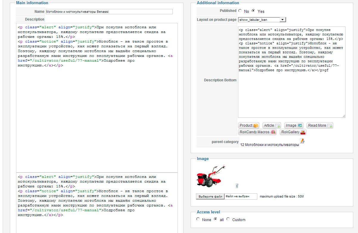

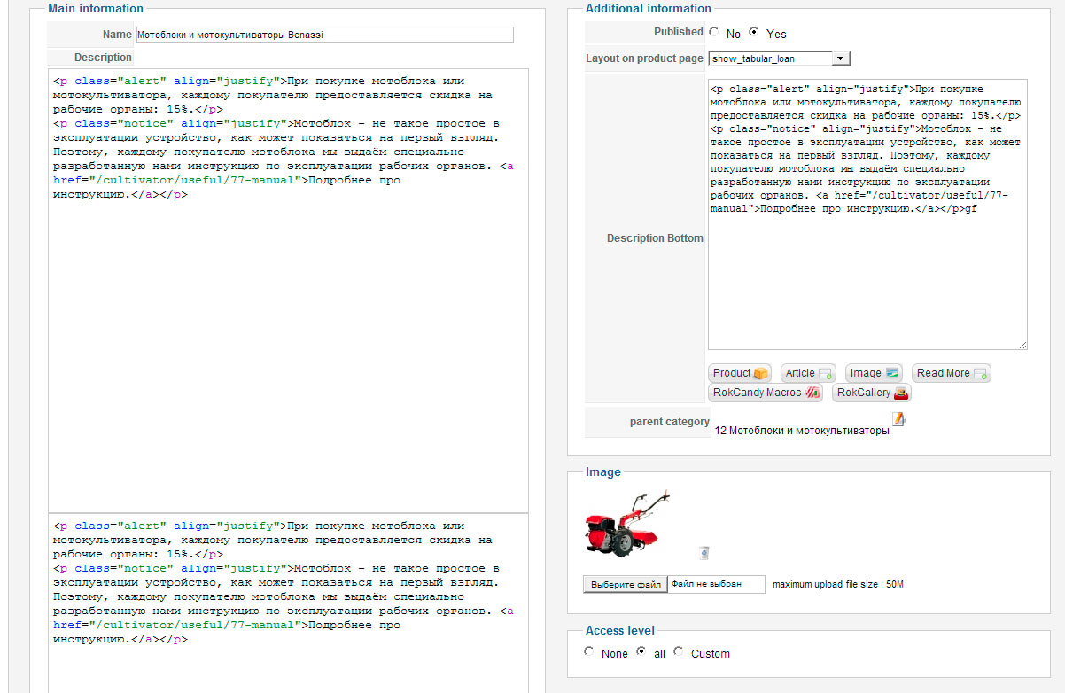

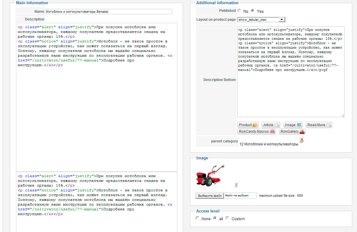

I understand the following piece fo code is responsible:
                    <?php $onWhat='onchange'; if($oneExtraField->field_type=='radio') $onWhat='onclick'; ?>
                    <?php echo $this->fieldsClass->display($oneExtraField,$this->element->$fieldName,'data[category]['.$fieldName.']',false,' '.$onWhat.'="hikashopToggleFields(this.value,\''.$fieldName.'\',\'category\',0);"'); ?>
I tried to modify it a little bit, but seems my "knowledge" of PHP is not enough to do even this simple modification?
                    <?php
                       $this->editor->content = @$this->element->descbottom;
                       echo $this->editor->display();
/descbottom is the name of my custom field/
Now it displays some extra editor's buttons (Product, Article, Image, Readmore etc), and also another text area under the main description:
What do I do wrong? It is not that simple? :)
