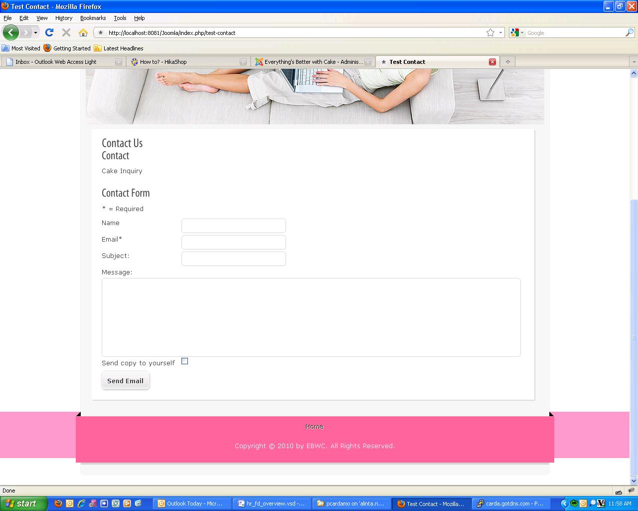

15 years 4 months ago #7555
Currently I am just using a standard Joomla form via a menu item. So I have a contact setup and category, and I have a menu item that is of type single contact.
See attached image.
I would like to add Product details such as characteristics to this form.
  • Posts: 85790
  • Thank you received: 14084
15 years 4 months ago #7557
Why do you you want to add characteristics in this form ?
Do you want the user to see it ? Select something ? Should that information be sent in the contact email ?
Either way, that's not something which we could easily provide I'm afraid since it does not directly involve HikaShop, so we don't know how that form works and it would take quite some time to provide such modification.
I can give you pointers if you know PHP/MySQL but I would first need you to answer my questions.
