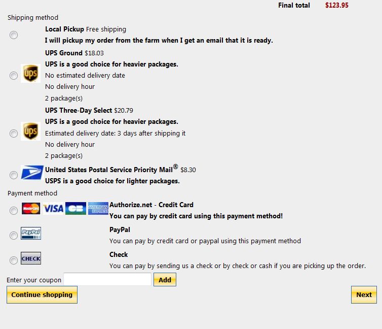

Below is attached a copy of an order with the shipping items displayed. They are sort of run together and I would like to separate them one space. How do I do this. What file and what little bit of code ?LIKE <div> </div>? should I add.

Hi there,
About the display thing you can add this css to your front end css file (System>Configuration>Display) and it should add space to between your methods:
.hikashop_checkout_shipping_radio{
margin:10px;
For the second problem I'm not sure I understood, where does this message appear? At the end of the checkout? Would you like to not display the TOTAL without VAT line?

:blush: I am sorry but I do not know how to get to the shipping css file - All I see is .php files in the display section??
