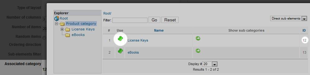

i follow step by step how to create a listing products on a menu :
- create a menu through "Control panel->Menu manager->Menu Item->New"
- set the "Menu Item Type" to product listing
- save on time
- configure your hikashop product listing through the "HikaShop Options" link
- set the "Associated category" to the category that you want to be displaid
The problem, when i select the associated category, by exemple "vêtements", so i click on "choose" , select "vetements" and when i save the change, it is modified in "2 product category" and never keep my choice.
In front end, it displays the 3 thumbnails of the 3 sub cat that exist in "categorie de produits", the parent cat create on installation of the component.
Thnaks in advance to help me.
Last edit: 13 years 9 months ago by iocom.
  • Posts: 26381
13 years 9 months ago #76392
Do you use the "+" button to select your wanted category ?
  • Posts: 2
13 years 9 months ago #76463
No, i click just next on the name.
On your example, i click on "license keys" ...
And immediately when i apply, the name of my cat is replace by "2 product category" ...
Any idea ? bug ?
Thanks in advance
  • Posts: 2334
  • Thank you received: 403
13 years 9 months ago #76611
Hi there,
Try to click on the plus, clicking on the name doesn't have the same behavior :)
