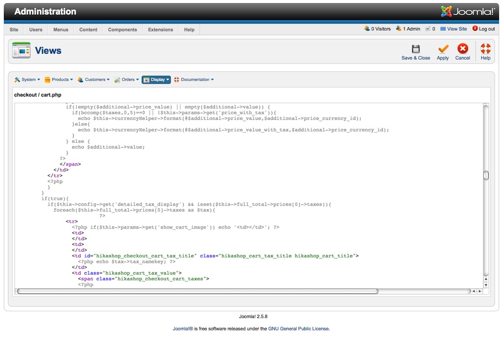

You would have to edit the file "cart" of the view "checkout" via the menu Display->Views and change the line:
if(bccomp($taxes,0,5)){
to:
if(true){
so that the tax line would display even for 0.

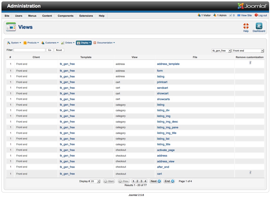

Yes, I'm as sure as I can be. After going to Display > Views, I select the template and 'Frontend' from the dropdown menus at the top right. I then edit the checkout/cart option (last line in the screen shot ZeroTax1.jpg), and make the change you suggested at line 185 (or so).

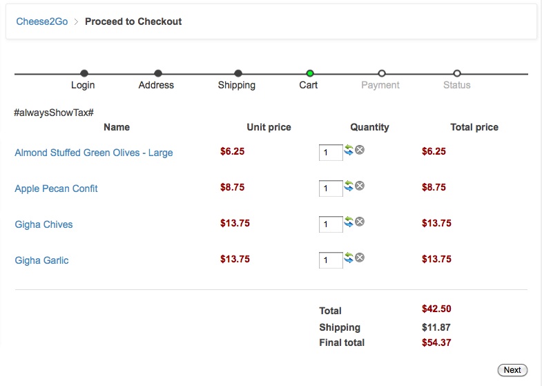

In order to see if you are enter in the right part of the code, you can put this test code
if(true) { echo '#alwaysShowTax#';
At this moment, if you're editing the right view and if the code goes in the if, the text would be display during the checkout.
  • Posts: 55
  • Thank you received: 4
13 years 9 months ago #77745
Yes 'Detailed Tax Display' is enabled in Configuration > Display. The added tag also shows up on at checkout after editing the same file as before (see attached image). Still no zero tax.
