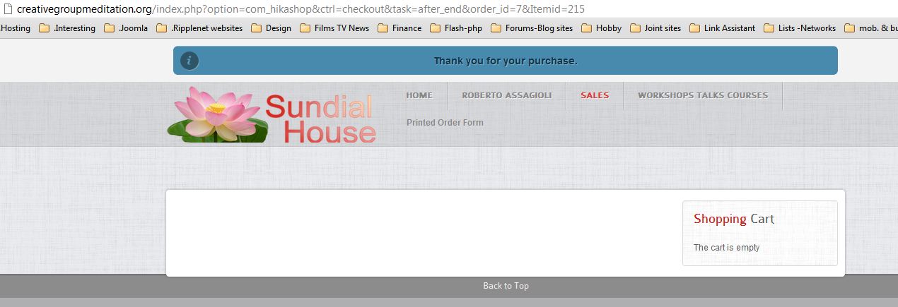

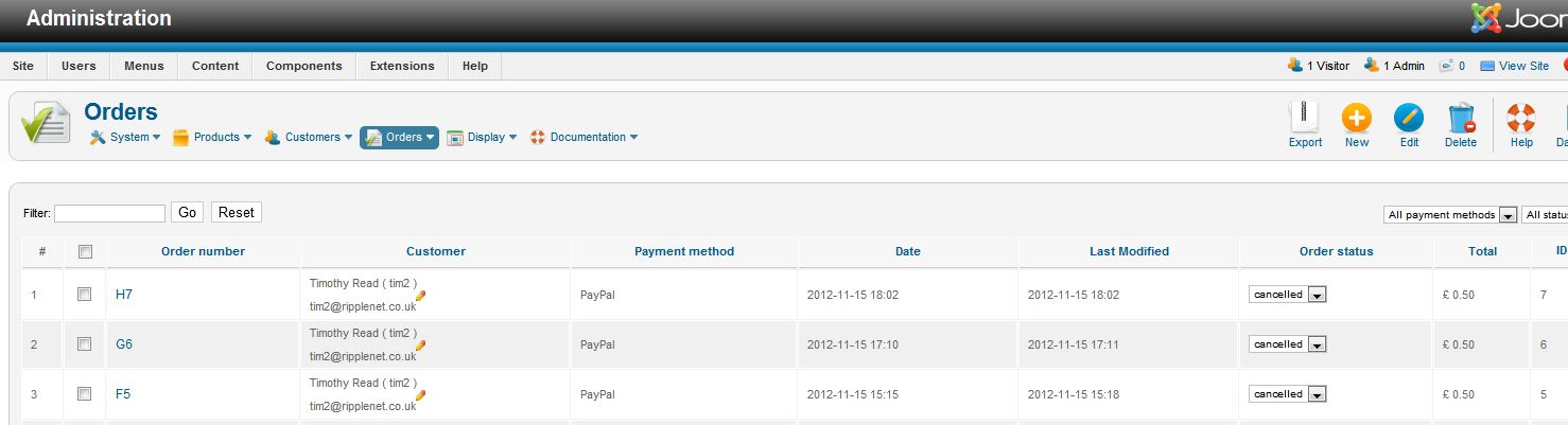

I can go through to paypal and then pay - and paypal takes the money out my account. I get a confirmed payment message (attachment 2), but I get a cancelled order status (attachment 3)

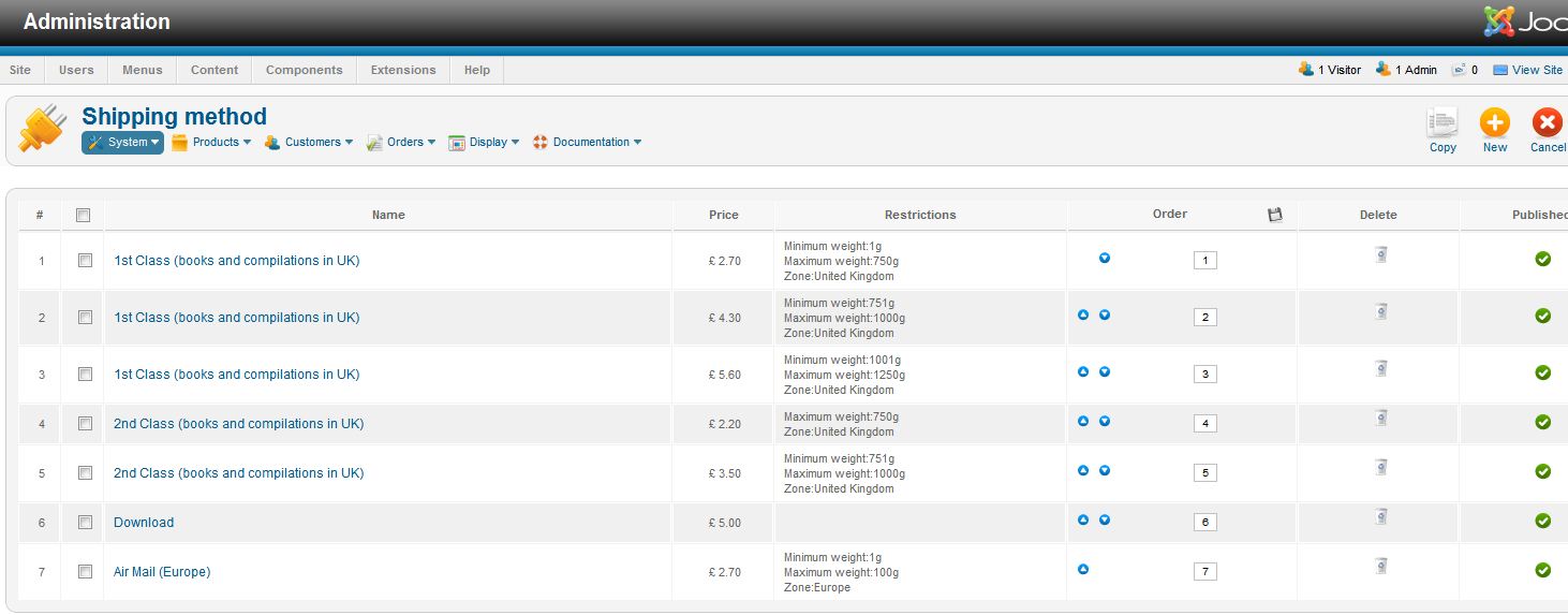

I set up the manual shipping plugin - (attachment 4)
Can you point me to where I am going wrong?

The main problem is that your order is cancelled.
If the order is cancelled, the customer can't download.
You can try to modify the order status to "confirmed" and you would see that the customer would be able to download the file.
But the main problem is to understand why your order is cancelled !

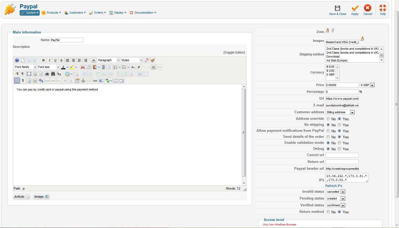

Could you please do a screenshot of the options of the paypal payment method options screen via the menu System->Payment methods ?
  • Posts: 12
13 years 9 months ago #77214
OK - here you are:
Tim
