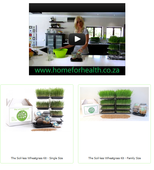

Hi, where and how do I move the description of a category below the product div layout.
Currently set menu = category layout div -> product div -> product info
So if you click category i have the following:
1)
video
(category description)
2) Product block div layout
and I need it to be like this after selecting a category:
1) Product block div layout
2)
video
