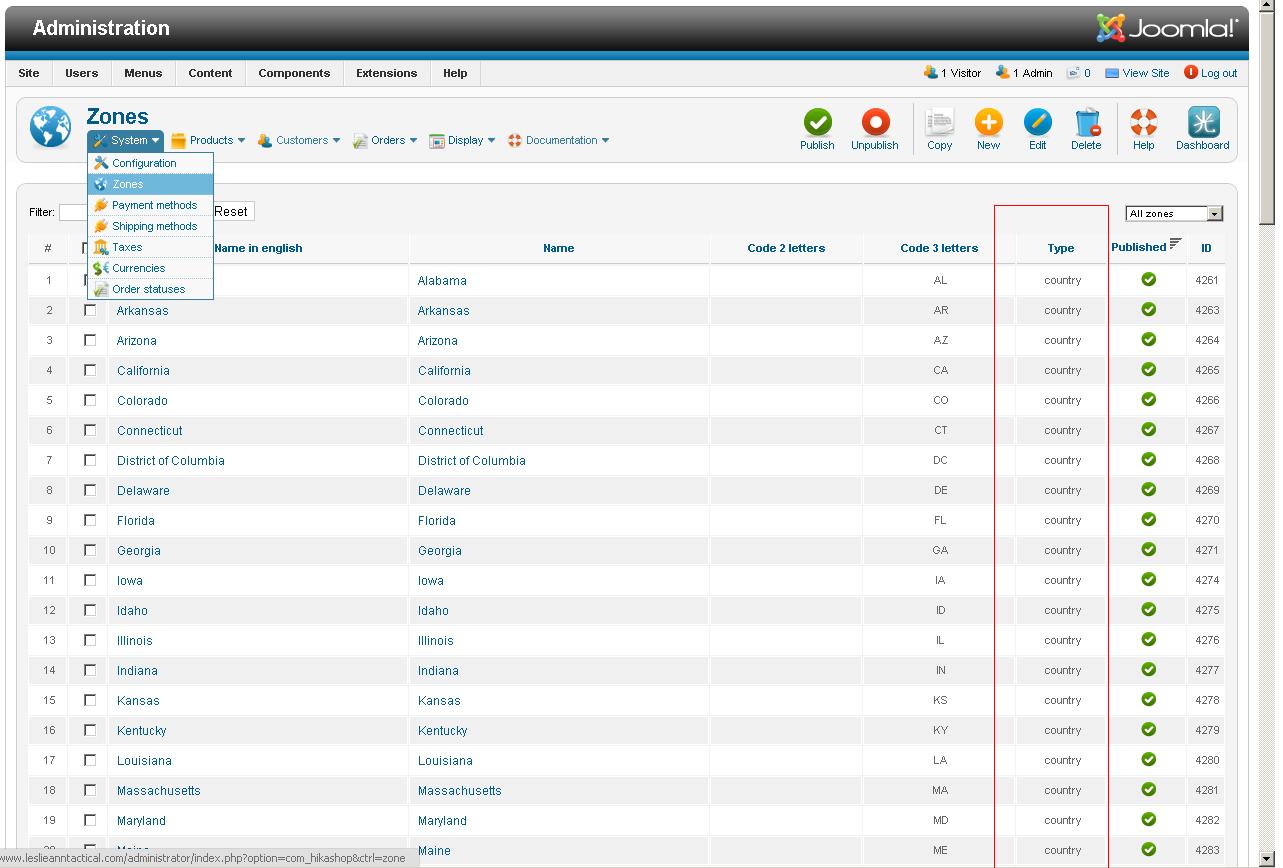

  • Posts: 9
13 years 9 months ago #77285
OK I've read a few ideas, Nicolas has a good idea, I am just too close to the problem and need to step back for a different perspective.
First: Reconfigure the hierarchy to have the state become the country, and the city become the state:
Step 1: Goto System -> Zones Select "Countries" from the right side dropdown box - unpublish ALL countries, even the United States
Step 2: while you are still in System -> Zones, Select "States" from the right side dropdown box
Step 3: Repeat 50 times, Select each state (that is in the US of course) and edit it
Step 4: Click on the dropdown box labeled "Type" and change it from State to Country

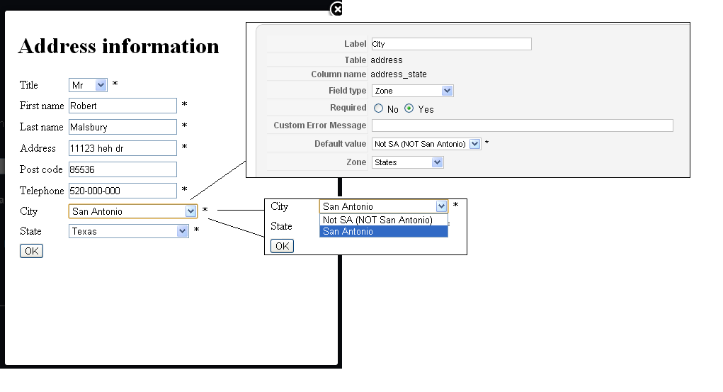

13 years 9 months ago #77286

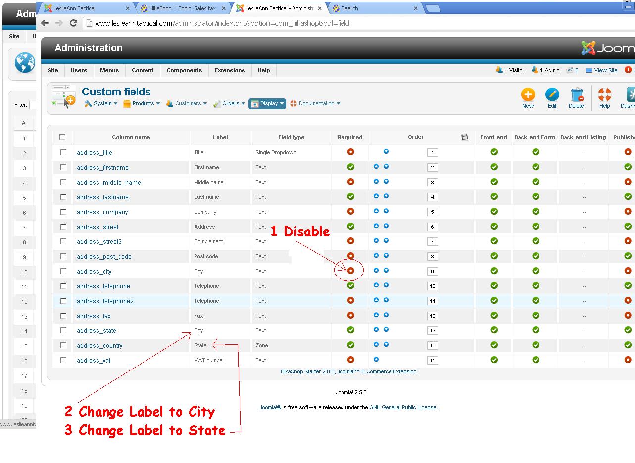

Next Reconfigure custom fields to trick customer into putting in the information you need, where you need it.
Hikashop Admin -> Display -> Custom Fields
Step 1: Disable field named Address_City
Step 2: Change Label on address_State from State to City
Step 3: Change Label on Address_country from Country to State
  • Posts: 9

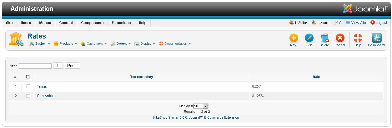

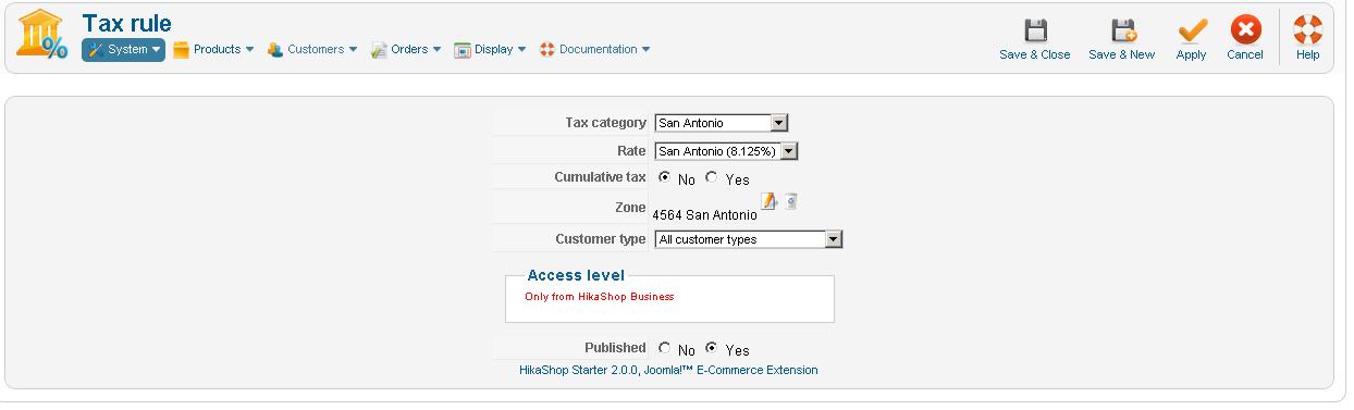

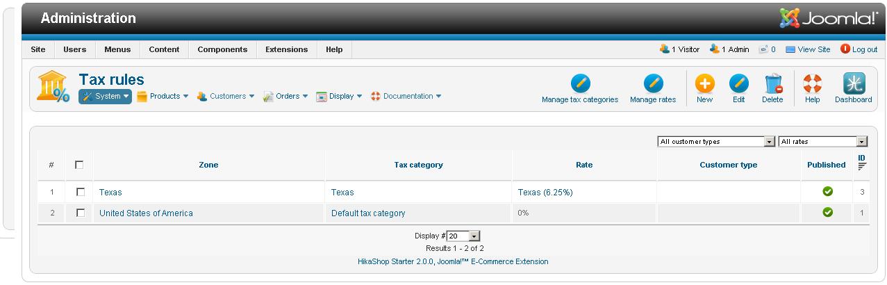

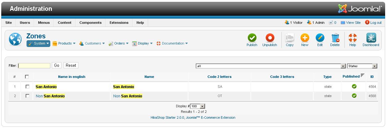

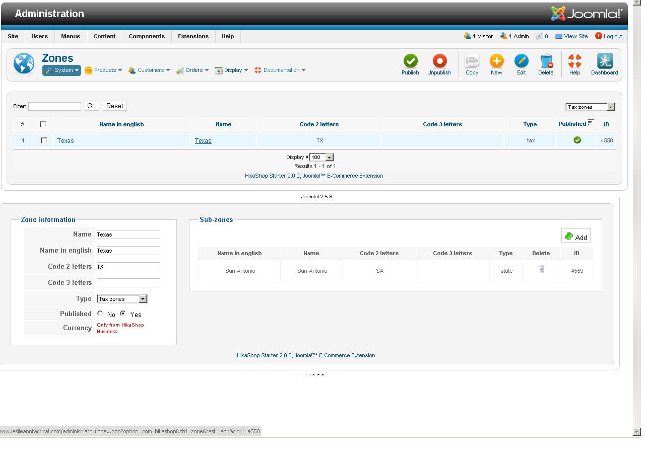

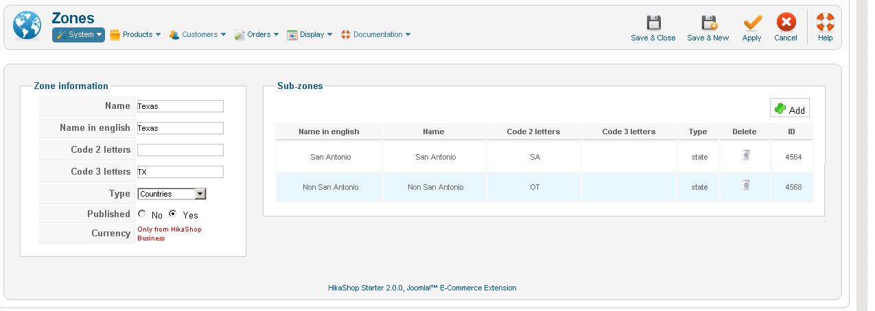

Next set up two zones
for me I am setting a zone up for San Antonio and a zone that ISNT San Antonio
I am setting them both to the type of "state"
Once those two zones have been created, I am going to go back and find the "country" zone for Texas and edit it.
I am going to add my two "state" zones as subzones of the country zone "Texas"

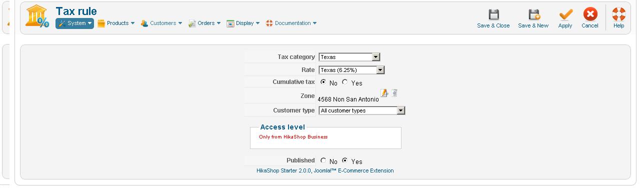

I will make two tax rules, one for Non San Antonio (with 6.250%) and one for San Antonio (8.125%)

You might reset the type of the customer field "address_state" in order to have another "zone" custom field.
At this moment, when the custom field "address_country" (with label "state") would change, it would update the content of the "address_state" drop down list (with label "city").
  • Posts: 9
13 years 8 months ago #77547
Hi Jerome!
I got it working but its not ideal. I set the field type back to zone from custom and it works.
If I select San Antonio / Texas, it charges 8.125% correctly,
If I set non-san antonio, Texas, it charges 6.25 correctly,
If I set it to some other state (really its the country code), it hides the city field (really the state code) and doesn't charge tax
While this works, I am sure it will be confusing to any customers when they are trying to put in their address.
