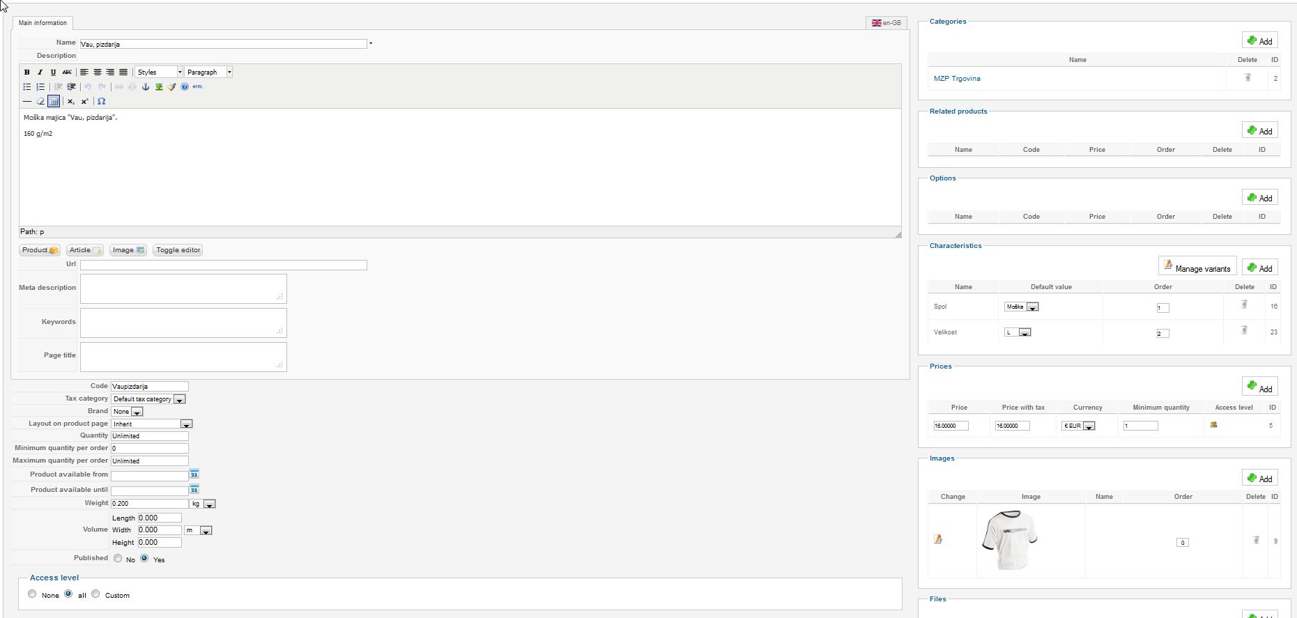

Hi Jerome,
here's the screenshot:
Click to view higher-resolution

  • Posts: 26381
13 years 8 months ago #77504
You shipping configuration is link to a zone.
If your customer is not logged in the front-end or does not have his address in the right zone, this shipping would not be displayed.
The other point is that, you accept virtual products (which does not have weight) but you set up a minimal weight.
You have to be sure that every products in your store have a weight, if not, the minimum weight rule would be applied and your shipping method would not be displayed.
