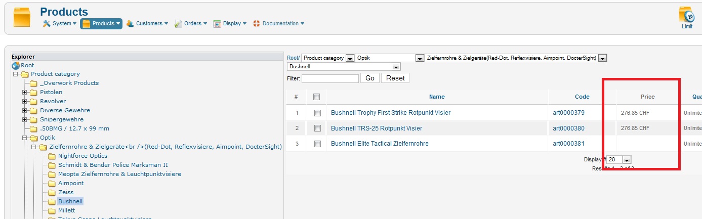

13 years 6 months ago #78952
Hello there
I replaced the following Code in the file "Back end / product / listing" from Backend:
<td>
   <?php echo $this->currencyHelper->displayPrices(@$row->prices); ?>
</td>
and just replaced this line with "888" to test, if there is a change in the backend:
<td>
   888
</td>
But it seems, that nothing happens (see Screenshot).
I don't know, where the problem may be...
I recently updated to HikaShop 2.0.0, but I don't know, if this is the problem (I don't think this is a problem).
Joomla is 2.5.8
Best regards
Mike
13 years 6 months ago #78966

I have here the price replaced with 8888!
Still no change in the product overview tables in the backend!
It's the following link that it opens:
www.waffenmarti.ch/shop/administrator/in...|product|listing.php
allrounder-j1.6 is my template
Last edit: 13 years 6 months ago by mike.

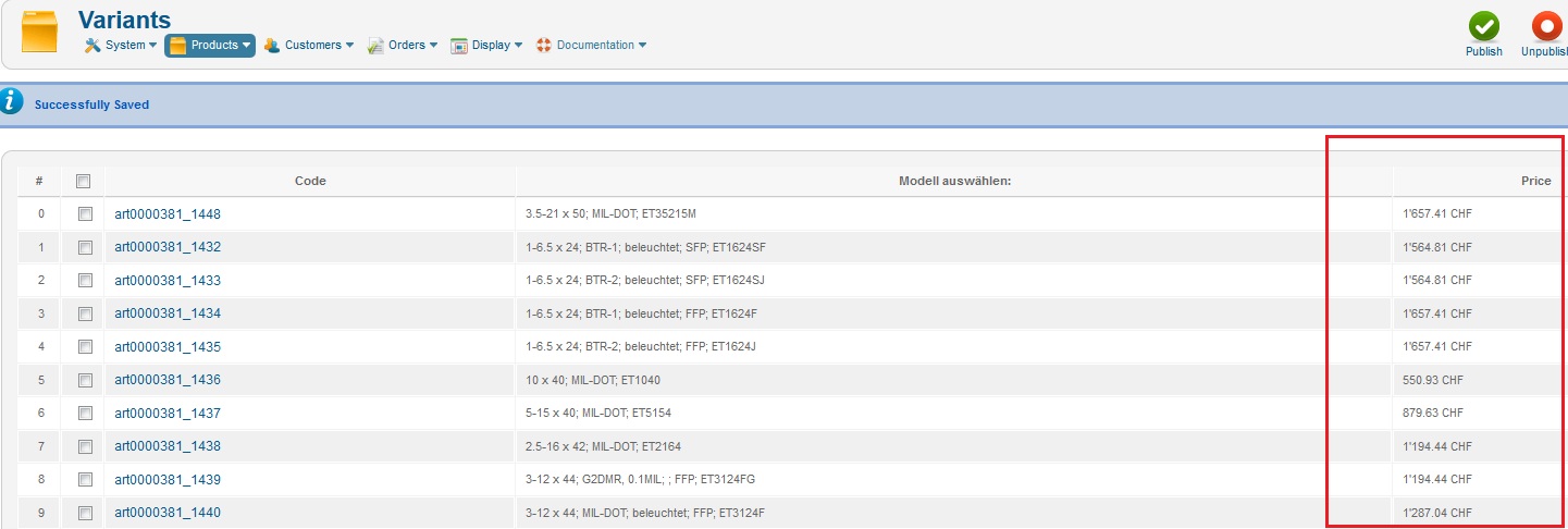

  • Posts: 92
  • Thank you received: 5
12 years 11 months ago #111407
Thanks for explaining how to make the prices including tax show in the product list.
However I would also like to be able to show the price of an option including tax in the product detail window, and to display the prices including tax in the 'manage variants' window for a product. Can this also be done by editing back-end views? If so, could you explain which ones and how?

Prices are not preloaded on these pages like on the product listing, so it's more complex to do.
Also, with next version of HikaShop during summer, the product edition page will be completely redone so I wouldn't recommend to do it, at least not until then.
