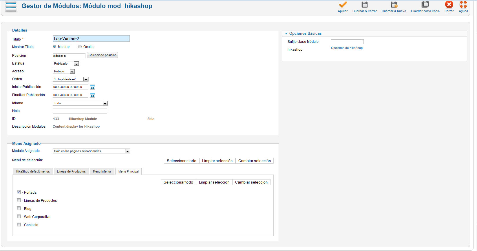

  • Posts: 441
  • Thank you received: 24

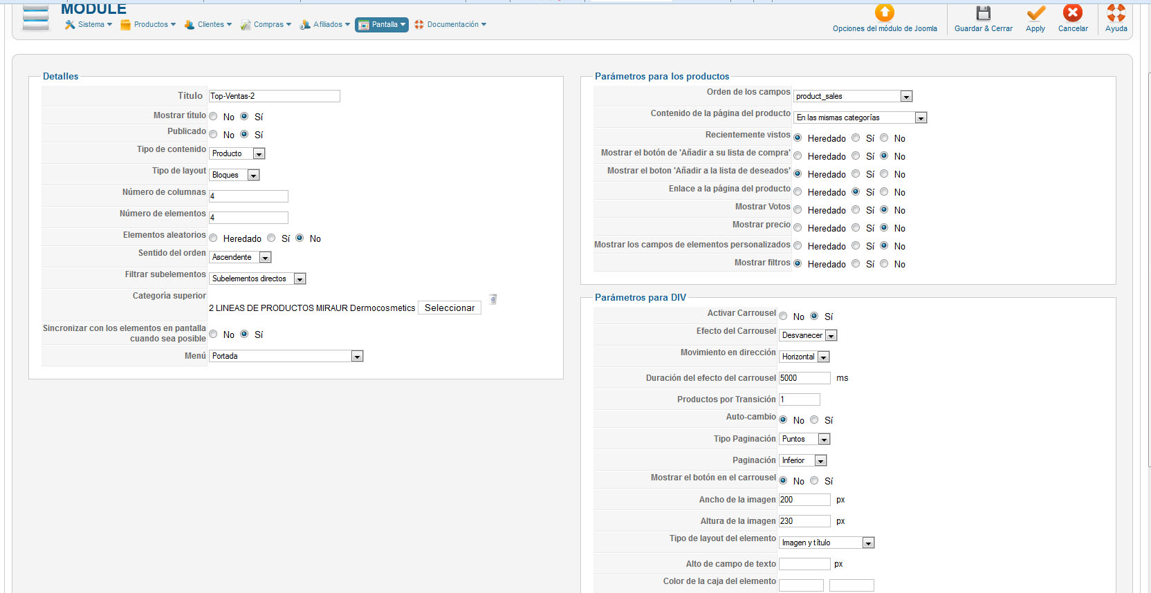

13 years 8 months ago #78102
13 years 8 months ago #78135

  • Posts: 26381
13 years 8 months ago #78225
Thanks for the access.
Your problem is now solved.
Your category "lineas de productos miraur" does not contains products. It contains category which contains products.
The option "Filtrar subelementos" (filter subelements) was set to "direct elements". But the category does not contains direct elements. I changed the option to "all sub elements" and the module have now products to display.
