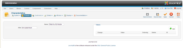

using hika business 2.0 and j2.5.8
i have created a characteristic seen here
i then created a csv to import the charateristic & it's variants:
product_parent_id product_code product_type TRIM PLATE FINISH
103872D 103872D-SSP variant STAINLESS STEEL POLISHED
103872D 103872D-SSB variant STAINLESS STEEL BRUSHED
when i import this, the variants are added as products, and therefore are not assigned properly...
what am i missing????

First, you need to have the values entered in you characteristic.
Then, in your import, you need to have the main product specified. So it should look like this:
product_parent_id;product_code;product_type;TRIM PLATE FINISH
;103872D;main;STAINLESS STEEL POLISHED
103872D;103872D-SSP;variant;STAINLESS STEEL POLISHED
103872D;103872D-SSB;variant;STAINLESS STEEL BRUSHED

OK, i think i finally understand...
the values can NOT be created by import, they must be done by hand first, right?
but once created, they can be assigned to product by import...
  • Posts: 26381
13 years 8 months ago #79090
Exactly !
