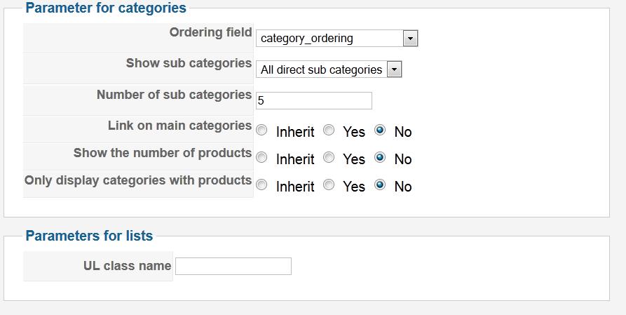

  • Posts: 113
  • Thank you received: 18
13 years 8 months ago #78597
I'm not understanding - and I see the same behavior on the Hikashop demo site.
When selecting a category from the menu "CATEGORIES OF PRODUCTS" in the left position, no descriptions are displayed, the parameters available are limited (attached) for type "list".
From the top menu on the demo site, selecting "Display Div / Table" from "Categories Listing" displays the category descriptions.
It would appear that category descriptions aren't displayed for type "List", which means a dynamic menu of product categories isn't possible if category descriptions are needed.

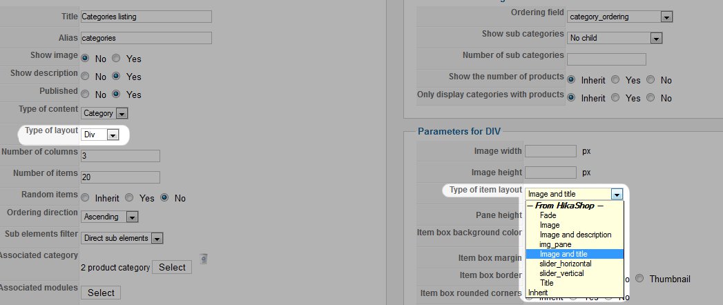

  • Posts: 26381
13 years 8 months ago #78603
It is because you are using a listing "list".
You have to use the type "div" in order to have the choice of the layout.
This screenshot, would give you more information:
