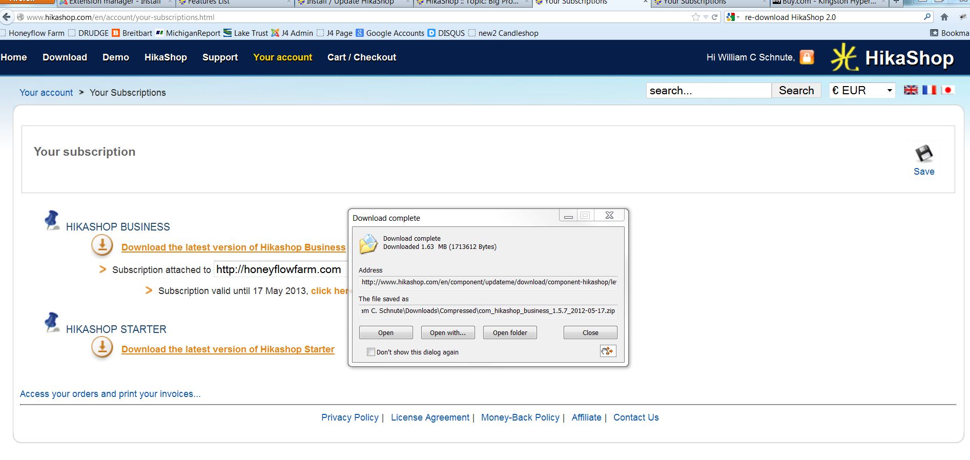

I did as you suggested and it lets me download this file:C:\Users\William C. Schnute\Downloads\Compressed\com_hikashop_business_1.5.7_2012-05-17.zip (I don't think that is the most recent.)
I also put in our website: www.honeyflowfarm.com but it reverted to: honeyflowfarm.com after saving. (I use www.honeyflowfarm.com )- and it did not help the "currently not attached to your website" in extension manager.
"Subscription valid until 17 May 2013, click here to extend it to 17 May 2014"

I think you didn't look at the right file.
When you download HikaShop, the date in the file is the current date. So if you had download HikaShop today, the filename would be "com_hikashop_business_X.X.X_2012-11-26.zip".
So your file "com_hikashop_business_1.5.7_2012-05-17.zip" have been downloaded the 17th May 2012, not today.
The current version of HikaShop is 2.0.0

13 years 8 months ago #78777
I understand what you are saying but the page is downloading an old one that I already have. This is the most recent one I have in my downloads file: com_hikashop_business_2.0.0_2012-11-07
I have a screenshot of what the page is letting me download...

13 years 8 months ago #78784
Please deactivate your special download manager or use another browser.
It is like your special download extension for firefox see that you have already download this file and do not re-download it.
HikaShop business file size is: 2 172 504 Bytes.
It is not possible for our script to send an old version of HikaShop.
