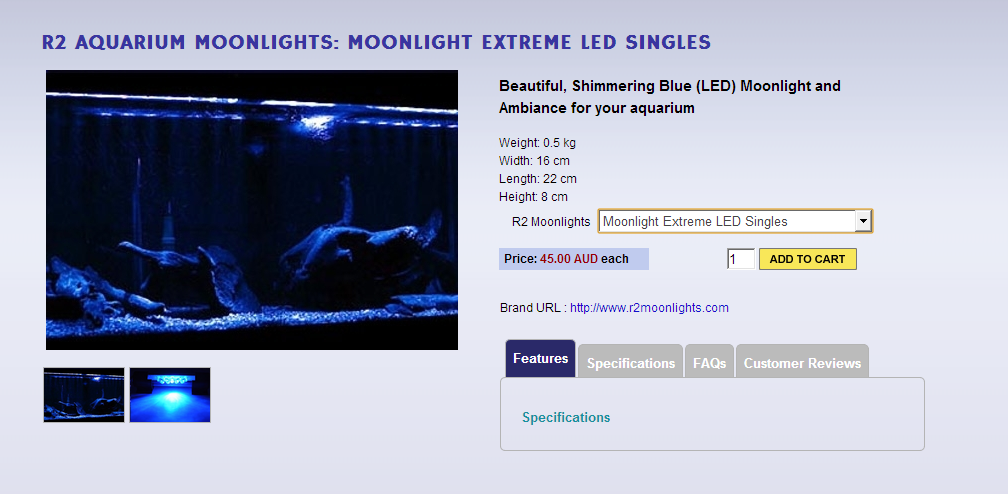

so we have a product - with default characteristics - say size = 1 and color = red
it has code 1r
BUT when you click around and try different selections then reselect size = 1 and color = red - it comes up with a different product called say product - size 1 - color red
which has a different code - but this is the same product with different entry
how can we make the product with default characteristics, the one and only product of it's type
TIA

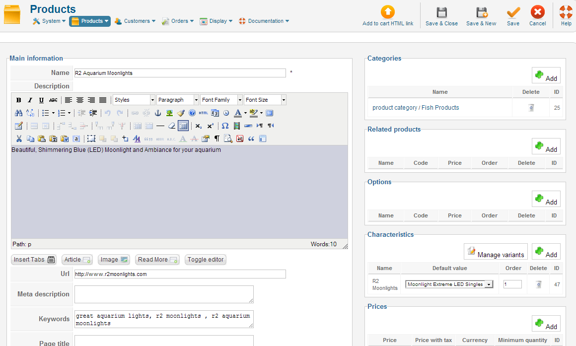

13 years 8 months ago #79396
The code should be the same, can you give us screenshot of your product configuration, and the listing of this product's variants ?

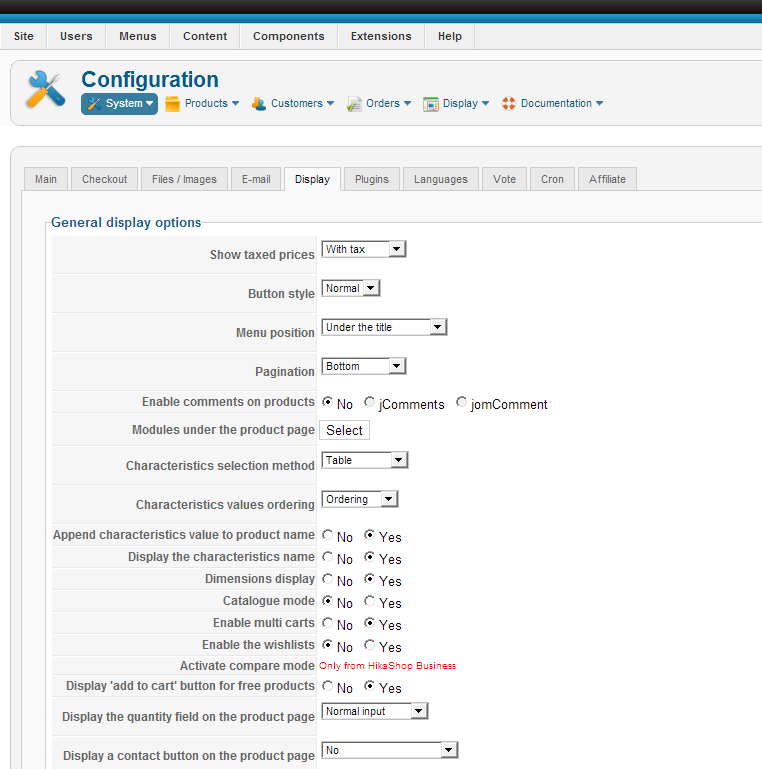

Try to enable the option "Display the characteristics name" in HikaShop > Configuration > Display.

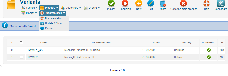

  • Posts: 10
13 years 8 months ago #80139
Hi thanks – we have this set but the PARENT PRODUCT code e.g. is ABC
Then when I go to manage variants – the DEFAULT VARIANT that is IDENTICAL to parent because it is same defaults – INSISTS on different code – perhaps I have to link to VARIANT in MENU NOT parent product – this is difficult for client to understand – but maybe a patch?

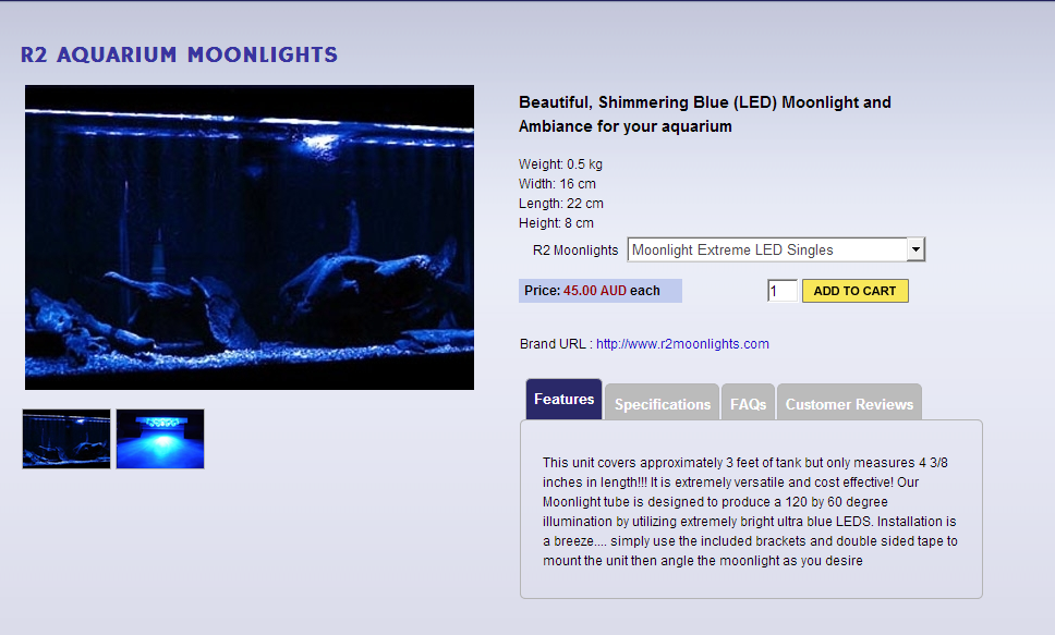

13 years 8 months ago #81400
The main product can't have the same product code than the variant, it's working like that in HikaShop.
But I think that you are talking about the product name, which is small when on the main product, and detailed when selecting a variant.
I have done a little modification in the view "product / show_default" I have commented a part like that:
      //      if (hikashop_getCID('product_id')!=$this->element->product_id && isset ($this->element->main->product_name))
      //        echo $this->element->main->product_name;
      //      else
        echo $this->element->product_name;
With this modification, the product name is always detailed, even if on the main product.
