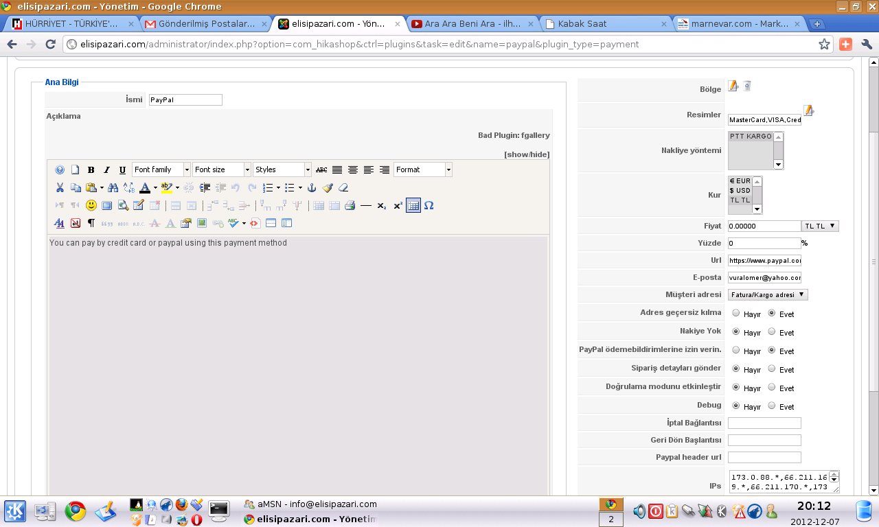

my paypal settings like this
  • Posts: 26381
13 years 8 months ago #80911
There is only the currency "TL" selected.
Please select all currencies (or none) in the currency list (using Ctrl or Alt key to add/remove a selection).
