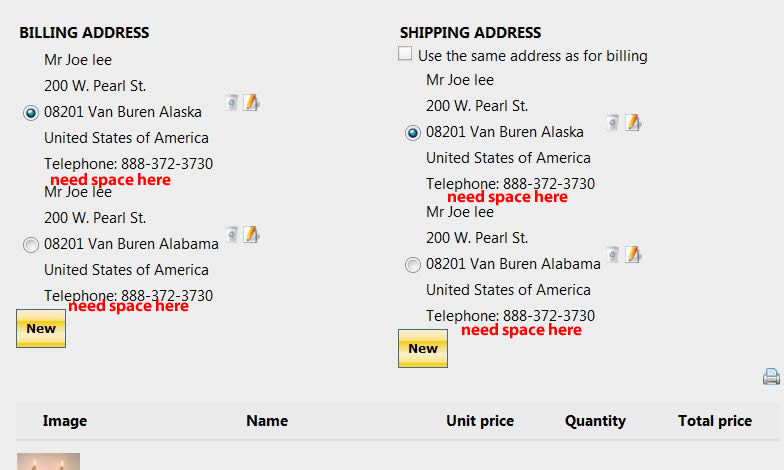

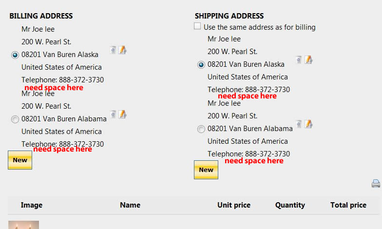

2 - I can add more shipping address ok - but they are all together vertically (along with the select box - ok) -- How can I put spaces between the different addresses to visually separate them?

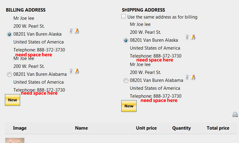

1 & 3 worked fine - but I added the css (shown below)to the bottom of the css file and it did not change. Attached is an image of them not visually separated - I think I should improve it.
.hikashop_checkout_shipping_radio{
margin:15px;
#hikashop_checkout_address table tr{ padding-bottom: 10px; }

13 years 8 months ago #80080
Try to use: #hikashop_checkout_address table td{ padding-bottom: 10px !important; }

13 years 8 months ago #80113
OK - thanks - that worked.

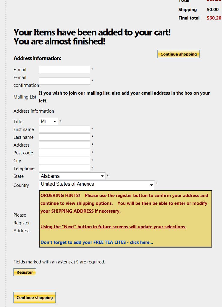

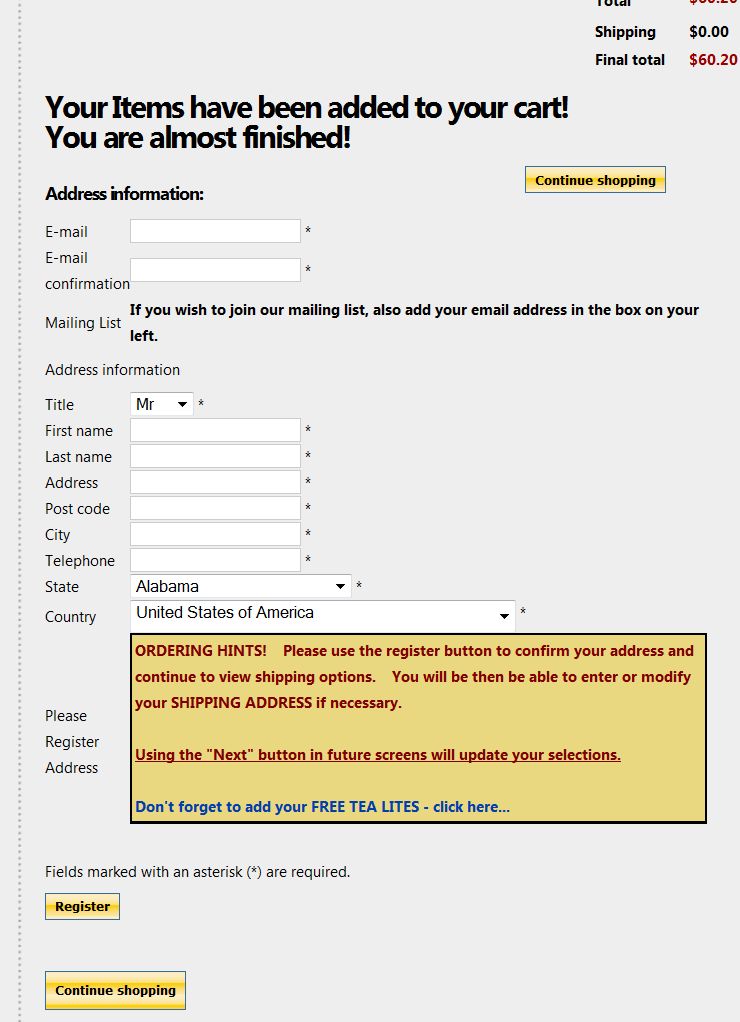

Also, since I could not get the little add to cart popup to work right, I changed it to load the checkout page after every addition. Now I would like the add the "continue shopping" button to the top of the page. What page is this on and what code do I use?
Also, a while back I changed the text of a button that now reads "register" I now want it to read "continue". It is DIRECTLY ABOVE THE "continue shopping" button. AND NOW I CANNOT FIND WHERE I CHANGED IT?? :woohoo: :blush: :evil: :ohmy: :( (Whatever applies to getting frustrated)

13 years 8 months ago #80168
I think that you are talking about the "Register" button in the checkout for adding an address, the translation line is "HIKA_REGISTER".
The continue shopping button is present in the view "chekout / step" to display it to the top, you have to place the code upper in the same file. The code is:
		if($this->continueShopping){
			if(strpos($this->continueShopping,'Itemid')===false){
				if(strpos($this->continueShopping,'index.php?')!==false){
					$this->continueShopping.=$url_itemid;
			if(!preg_match('#^https?://#',$this->continueShopping)) $this->continueShopping = JURI::base().ltrim($this->continueShopping,'/');
			echo $this->cart->displayButton(JText::_('CONTINUE_SHOPPING'),'continue_shopping',$this->params,JRoute::_($this->continueShopping),'window.location=\''.JRoute::_($this->continueShopping).'\';return false;','id="hikashop_checkout_shopping_button"');

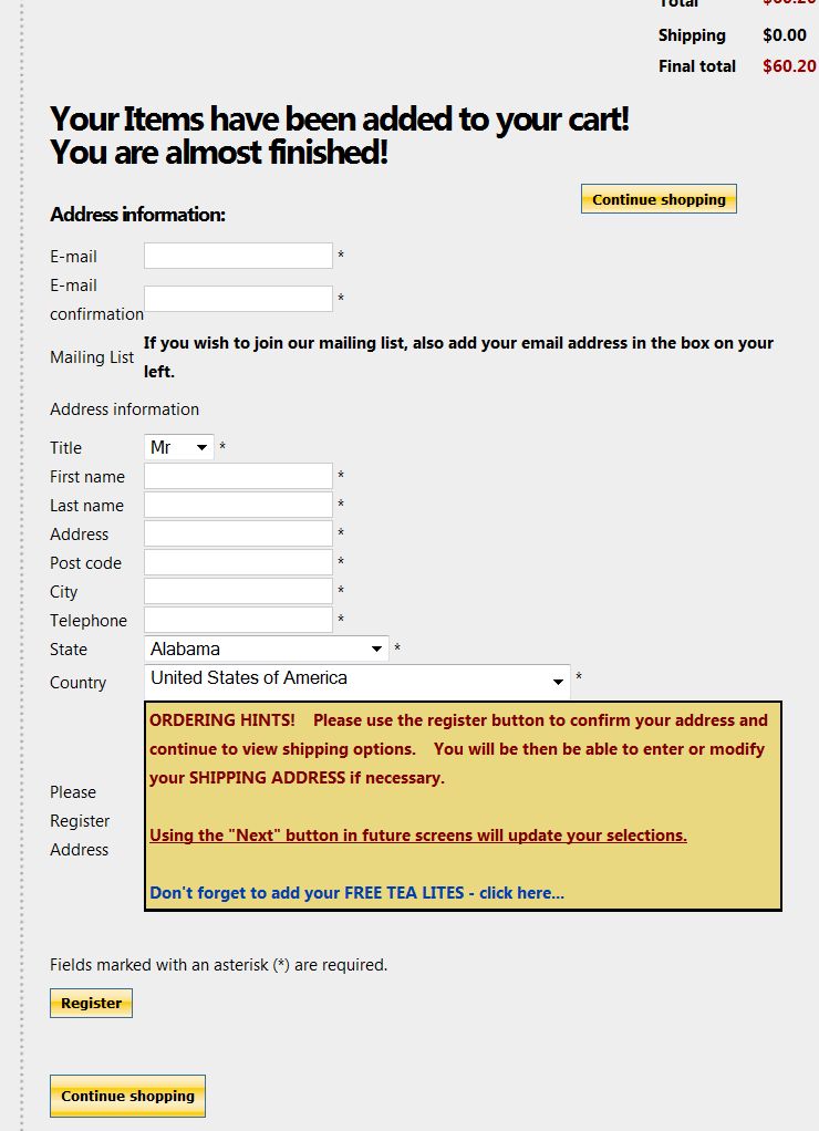

13 years 8 months ago #80221
Thank you , I have added the extra "continue shopping" button ok. My frustrating problem is I changed the text on a button now called "register", on the bottom of the attached page, and I cannot find what page it is on to edit it (or it now looks different.

13 years 8 months ago #80242
The "Register" button is the original one, by default it's called "Register". To change the translation, you have to go in HikaShop > Configuration > Languages. And replace the translation for HIKA_REGISTER.
It is displayed in the view "user / registration".
If you do you modifications in HikaShop > Display > Views, in the Frontend CSS File, in the Override part of the language files, you will lose nothing.
