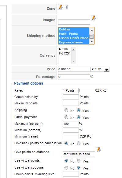

c) This was on my test environment and I was / am on 2.0 there for some quite time (I can provide you with credentials if needed via PM). The configuration is:

  • Posts: 26381
13 years 7 months ago #84558
Some options are not compatibles between them.
"Shipping" is not compatible with "Virtual coupons" because the coupon could not affect the shipping price.
Which payment plugin do you use with AlphaUserPoints when the final price is zero ?

  • Posts: 26381
13 years 6 months ago #86727
"Why not" why ?
The virtual coupons are not compatible with the shipping price. That's a current limitation of the system.
If there are not compatible it means that it could not work...
You can remove the "virtual coupons" option if you want a good compatibility with the shipping price.
