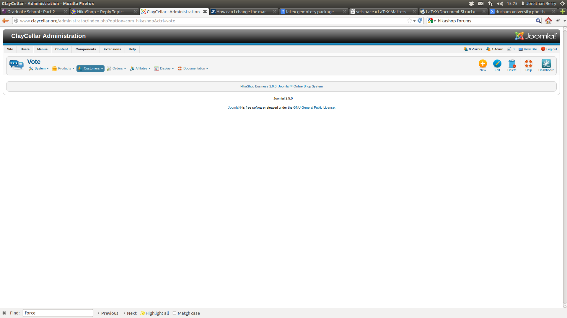

I go to the vote page under "customers" in the back end and get an empty frame with no information in it (the heading above hikashop menu system says vote, but below there is nothing).
Any other ideas?

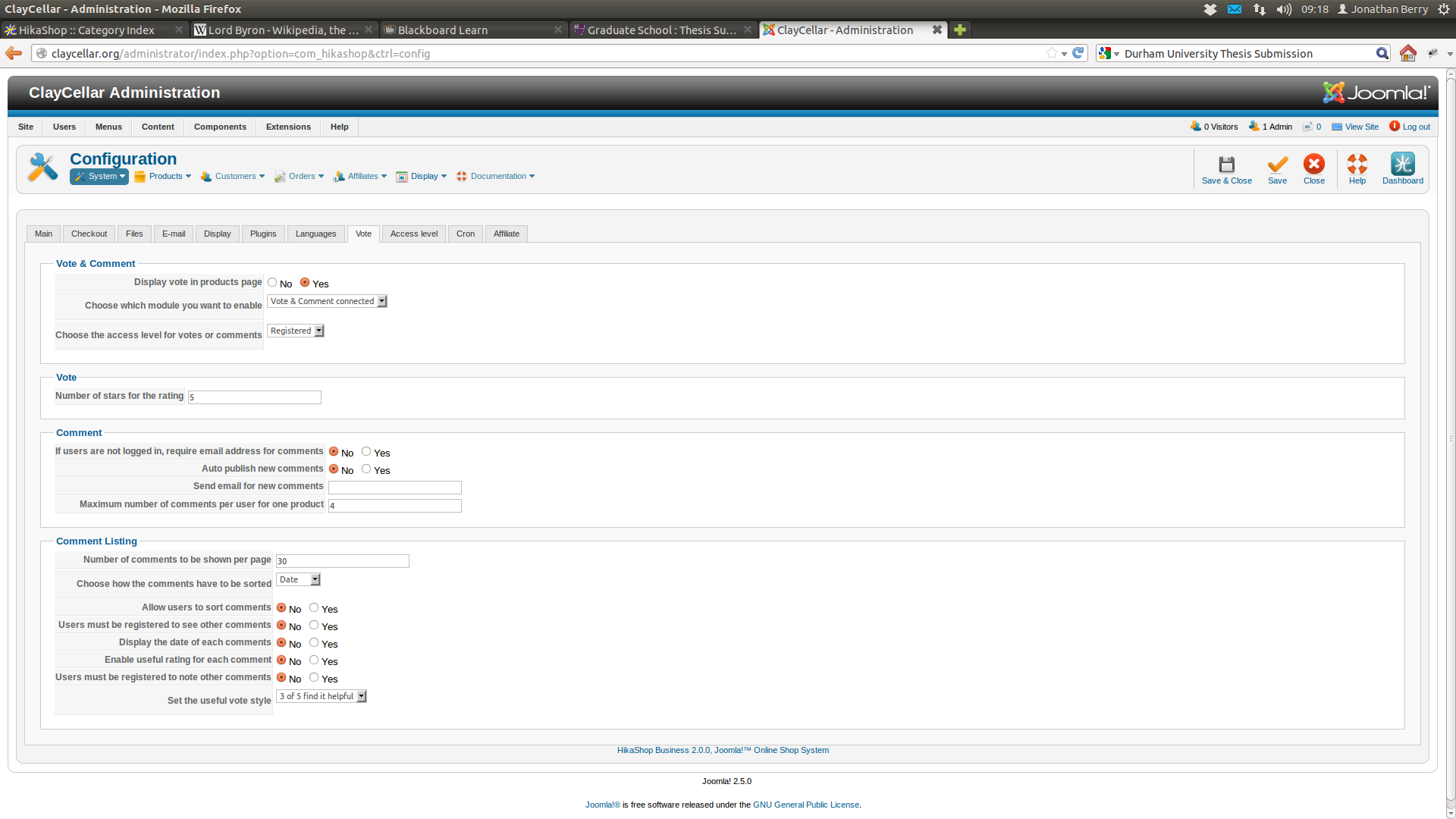

Can you please do a screenshot of the Vote tab of the configuration so that we can see all your vote related settings ?
  • Posts: 76
13 years 8 months ago #81180
Ok, it's attached.
Thanks so much for your help.
Jonathan
13 years 8 months ago #81185
You vote configuration seems to be correct.

13 years 8 months ago #81221
Yes I see that the review is not displayed, that's normal because the option to auto publish is not set to "Yes".
I was asking for a screenshot of your backend, in the menu customers > vote, to see what happen in backend.
  • Posts: 76
13 years 8 months ago #81251
Oh, I see, sorry! With you...
The screen shot is attached.
Jonathan
