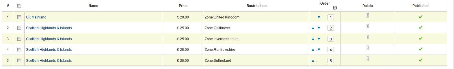

Just a little update.

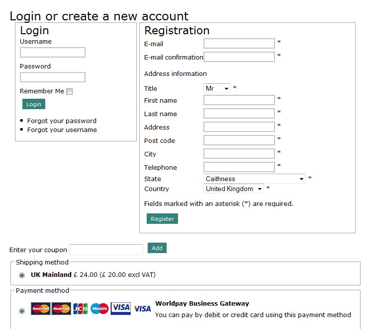

I created 5 shipping charges as per the first screenshot and assigned the zones but when you add a product to the cart and select Caithness for instance the shipping rate does not update. The option does not even appear. They are all published and are also United Kingdom zones. The products do not have a any weights assigned and the Virtual Product box is ticked.
I really would appreciate some help with this as I cannot see an obvious reason for this not to work
Dave

  • Posts: 26381
13 years 8 months ago #81514
You can set a zone on manual shipping configuration.
A zone could be a country, a state or a collection of countries/states.
After that, you can set rules on postal codes (minimum value, maximum value).
If you are not logged, the default location would be load from your default tax zone.
You have to use an account and to modify his billing/shipping address.

So the shipping options will not update until they have created the account? I have hoped that one they selected an area as above the shipping option presented would be for Caithness only for instance? Is this possible?
Dave B)
13 years 8 months ago #81659
The shipping methods are displayed depending on the shipping address of the customer, what you can do is add another step on your checkout, the first on with: "login_address" and the second "coupon_shipping_payment".
By this way only the compatible shipping method will be displayed.
