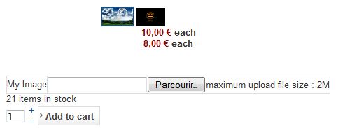

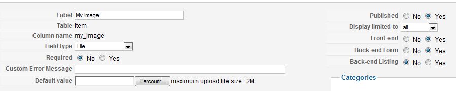

  • Posts: 26387
  • Thank you received: 4078
13 years 9 months ago #81466
The "problem" is that, a "file item custom field" is working. We have several websites which use it every days.
First, create a item custom field, with the type "file", like in this screen shot:
And after that, you would have the upload section in your product page, like in this screen shot:

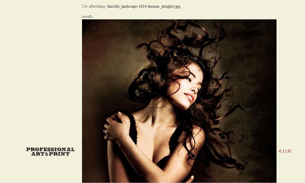

  • Posts: 19
13 years 8 months ago #85153
Hi Jerome, thats fine, except the image will show now in it´s full size. As my client expects huge files the whole site layout will be broken. Where and how can I change the dimensions of the upload image that is shown in the cart so that i can set it to a default size like 320x240px or even just one dimension like width?
Please reply with view name and the code!
Thanks a lot,
Dimitri

  • Posts: 86216
  • Thank you received: 14222
13 years 8 months ago #85259
You can simply force the size of the image with CSS on your website:
.hikashop_custom_image_link{ width: 100px !important; }
You can potentially add that CSS in the frontend CSS file of HikaShop via the Display tab of the configuration.

  • Posts: 19
13 years 6 months ago #92185
Hi, I want an image upload in the cart in the right dimensions. So the custom field is show not in its full size. see attached image
Where can i edit the dimensions?
