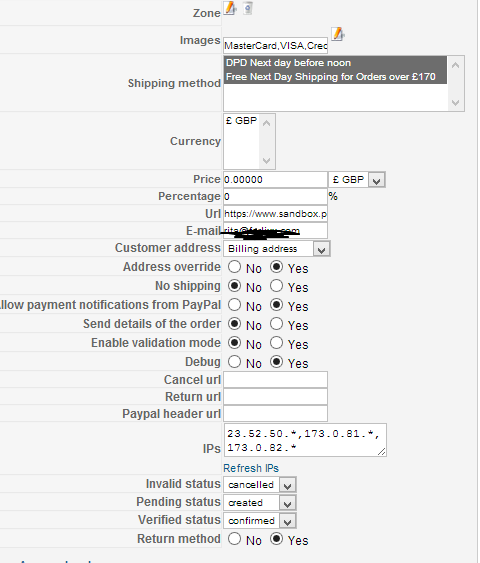

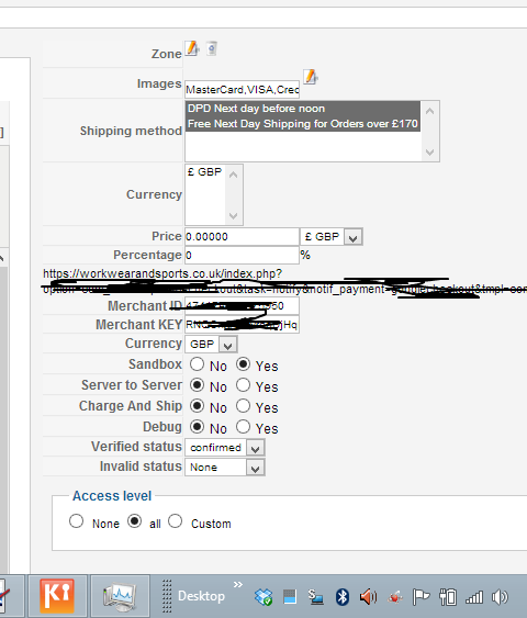

Hi I have followed the instructions and setup paypal and google checkout.
I have been testing it out with the sandbox for systems.
I am also just in the process of setting up the SSL Certifcate for my domain.
However once the order has gone through and I have paid via either google or paypal.
When I go into the orders however they simply appear as created and not confirmed?
Please see the attached screenshots. I think in the case of paypal it maybe because my SSL is not yet setup or am I wide of the mark here?

We I tried to open your website in HTTPS, I have got an error:
ssl_error_rx_record_too_long
I think that Paypal and Google can't connect to your server to validate the orders. Like I can't connect too.

Now that the SSL is installed the google checkout was working fine,

That's because the automatic payment validation is deactivated in your sandbox account. That should normally be turned on by default though.
