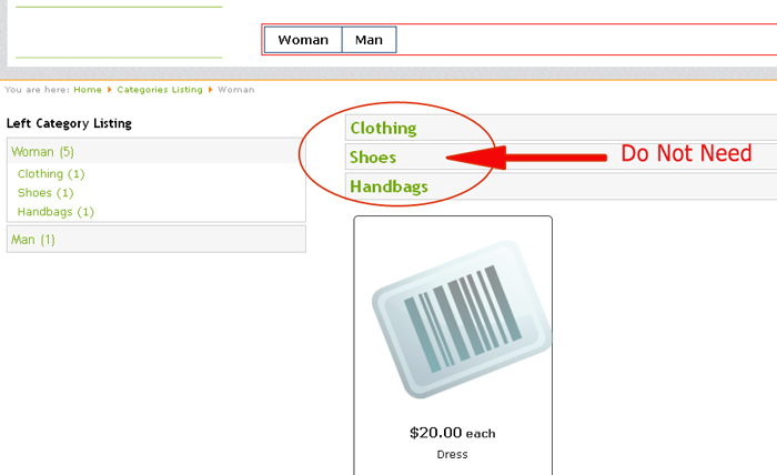

A couple issues with my menu.
1) When I click on the category "Woman" it shows the 3 categories on the right, as per the attached image. How do I get rid of that please?
2) When I click on each sub-category it's displaying the same products for all of them although I uploaded different products in those sub-categories. Sometimes it doesn't show anything at all...
3) Also, if you notice it's showing that I have a total of (5) items. I have a total of (3) items. As you can see next to each sub-category they each have 1 item. So I'm not sure why the category is showing (5) and not (3).
4) The other issue is when I click on the other category "Man", it opens then closes. It DOES NOT stay expanded like the "Woman" category.
5) Lastly, I am really, really having troubles with the images. I uploaded images for all the sub-categories under "woman" and they are not showing. So I cleared may cache (backend and front), tried again, 2 more times, and it's still showing the default image.
I'm not sure what's going on here but if you can help it would greatly appreciated. Otherwise I may just have to reinstall as I cannot figure out what the issues are...

13 years 7 months ago #82723
1. In the "menu" option of your categories listing module, instead of having a categories listing menu selected, you should select a products listing menu.
2. Can you give a link to the page ?
3. It might come from point 2. If you have two products in different sub categories of a category, it might count strangely.
4. That's because of point 1. The solution on point 1 should normally solve that too.
5. sub categories ? Your listings of categories are displayed with lists on your screenshot, it's normal that you don't see the images.
Did I miss something ? Or you meant for the products ?
Could you give more information on what you did ? Maybe a step by step with the screenshots ? Do you see the image on the backend ? On the frontend ? H%ow did you upload it ? via ftp ? via the uploading system in HikaShop ? Wasn't the file too big ?
