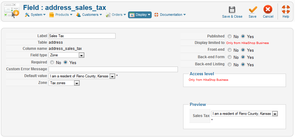

I have everything set up where I can change sales tax based on the address_state field (if they're in Kansas, then they get charged, but otherwise it's 0%). However, that doesn't satisfy his needs.

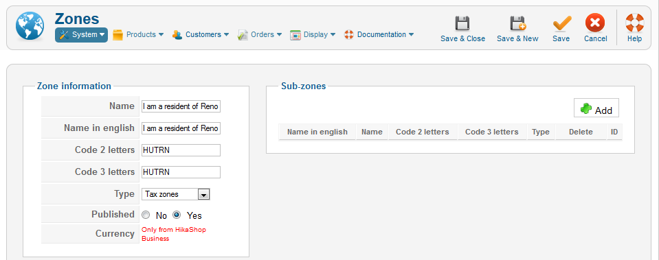

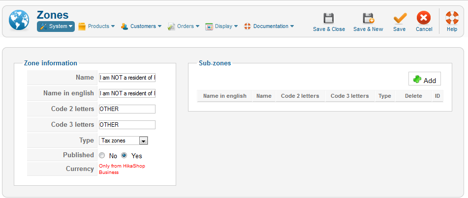

It would seem like a custom zone field in the Address table should fix that. I created a new Tax Zone, with two entries - "I live within XXXX county", and "I do NOT live in XXXX county".

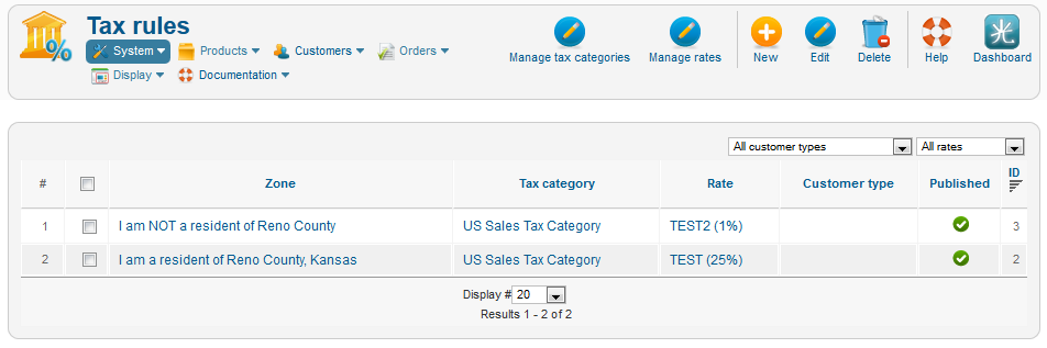

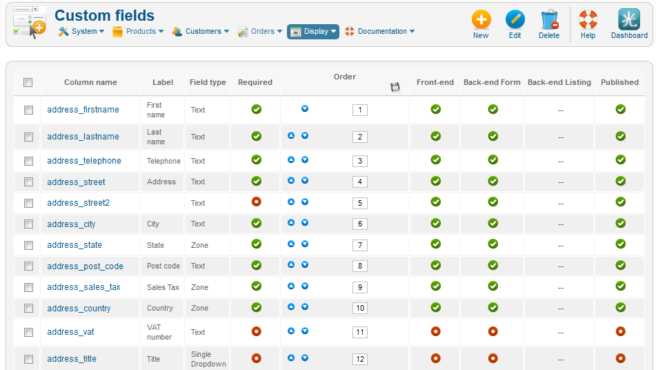

Like I've said, I added the zone to the address table, and that shows up in the Address section, but I cannot figure out how to make the Tax rules observe this.

I'm uploading screen shots of my current config if that helps.

The tax zones are used with the tax system.
You can create a tax zone in order to define the different zones for taxes.. A tax zone.
The customer have an address, with a country and a state. Depending to his address, HikaShop would retrieve the compatible tax zones and would get his current tax rate.
So, a tax zone allow you to create a special zone, with countries and states, which would have the same tax rate.
