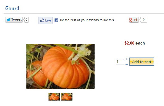

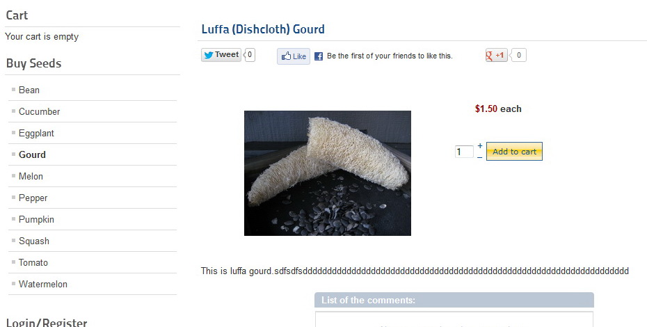

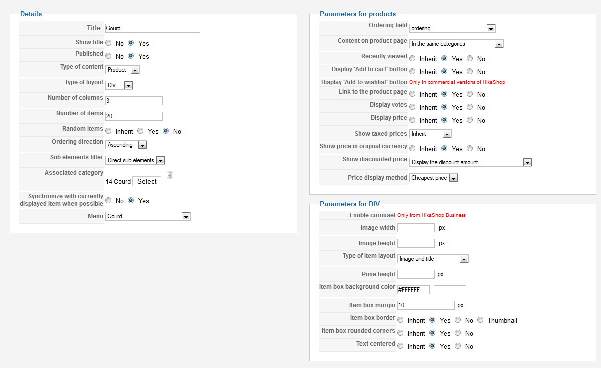

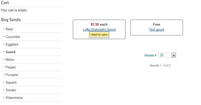

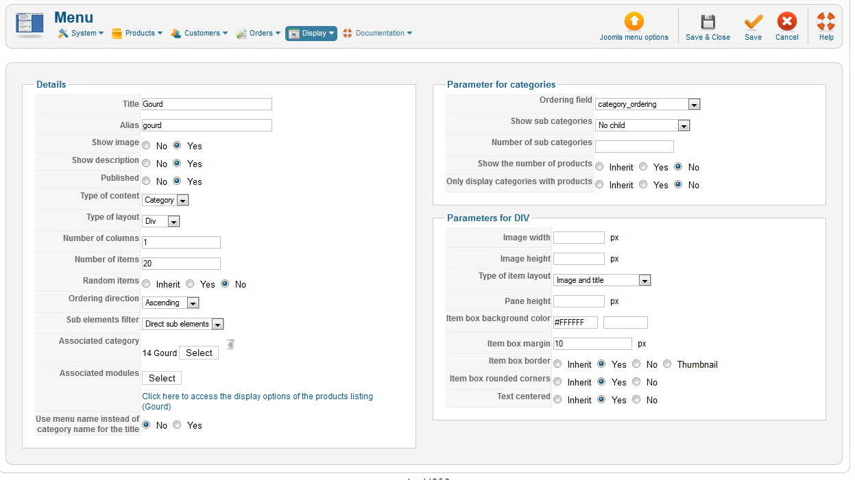

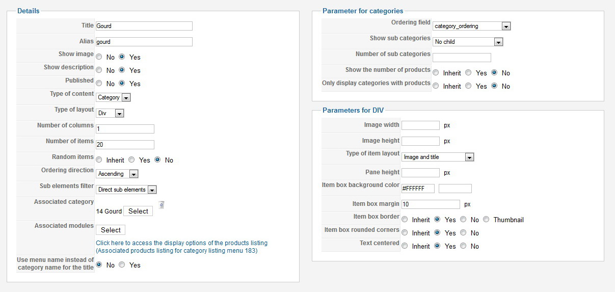

Hi, I am currently using HikaShop version 2.0.0. I have assigned category listings to each menu that is displayed on the left side of the page (Attachment1). Along with product title, I would also like to display product images in the product boxes when clicked on a menu; however, I can't get it to work. On the other hand, when I click on the product title, the image can be displayed (Attachment2). Attachment3 shows the back-end settings I am using. Could you please help me to fix this?

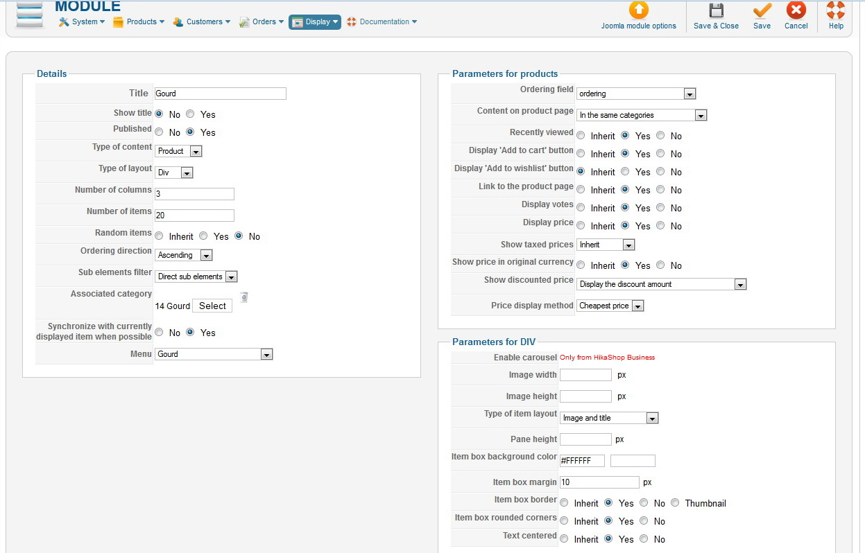

  • Posts: 47
13 years 7 months ago #84281
Hi, thanks for your response. I have attached the screenshot for the associated product module. I have played with the image width and height parameters but it didn't impose a change. Module is published, associated category is selected, corresponding menu is also selected.

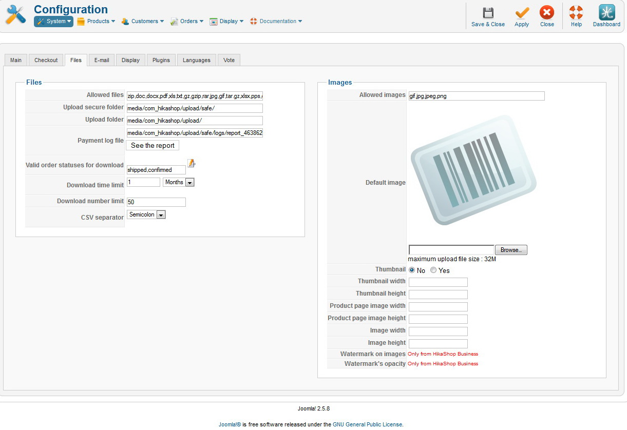

Can you give us a screenshot of your images configuration ? (hikashop > configuration > files)

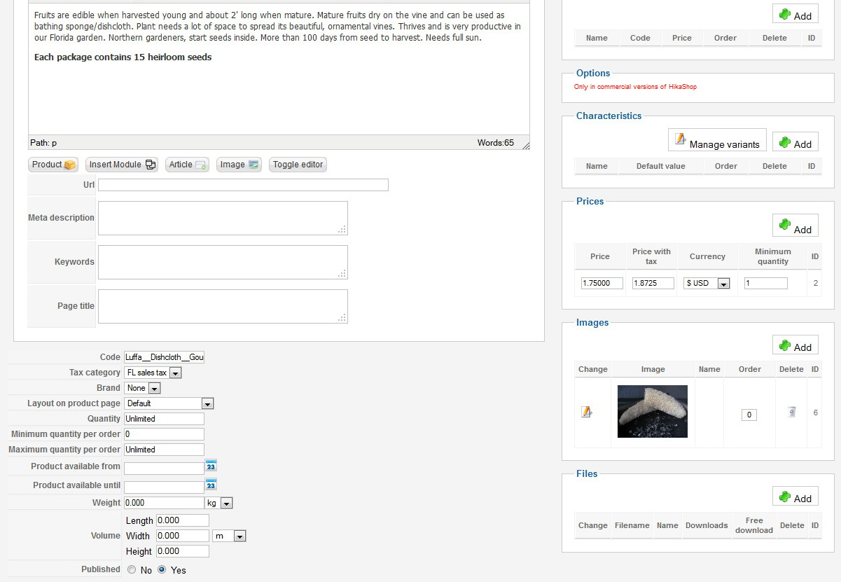

  • Posts: 47
13 years 7 months ago #84426
"Do you have edited the view "product / listing_img_title" ? You have maybe removed the image part of this view."
I couldn't understand this comment.

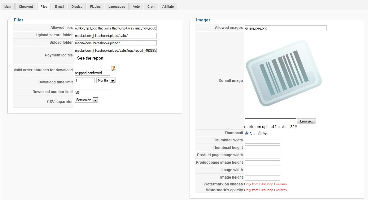

I have added the product image through the "Images" tab (Attachment5). I haven't inserted any images to the product article. Also, I haven't uploaded any images to any Hikashop folder. In Media Manager I don't see any Hikashop folders, either. Hikashop>Configuration>files screenshot is attached (Attachment6).

13 years 7 months ago #85677
Hi Jerome,
Now I checked the Files tab and attached it. It looks like in the back-end everything seems to be the same as you indicated.
Also, I have checked the permissions of the com_hikashop/upload folder, and they are all checked (Read/Write/Execute).
  • Posts: 86051
  • Thank you received: 14179
13 years 7 months ago #85735
I've read all that thread and I think that everyone got confused on a simple thing.
Actually, the reason you don't see the thumbnails on the listing of products is because you changed the "item box layout" option to "title" instead of "image and title" in your products listing module.
The screenshot of the options that you have shown us is the listing of categories menu to which the products listing module is attached. It only affect the categories listing display, not the products listing display.
So on the option page www.hikashop.com/media/kunena/attachments/12567/Attachment3.jpg , you need to click on the associated modules link on the left bottom and that will display the options of the products listing module. There, you can change the layout option in order to display the images.
  • Posts: 47
13 years 7 months ago #85845
I am going to walk you through what I have. I do NOT want to see a thumbnail in my product box. I want to see the true image of the product when the customer clicks on a menu. I summarized what I want to do in Step1 and Step2 (attached). Also, I took screenshots of back-end settings (attachments Menu, HikaShop Options, Module). It actually is very simple and I believe could be fixed in 10 secs.
- Are my images supposed to be equal to or smaller than a certain resolution?
- Is there a problem with the module assignment? Instead of assigning a product listing module to my category listing, should I use another module?
- Anything else?
