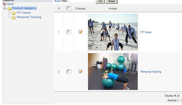

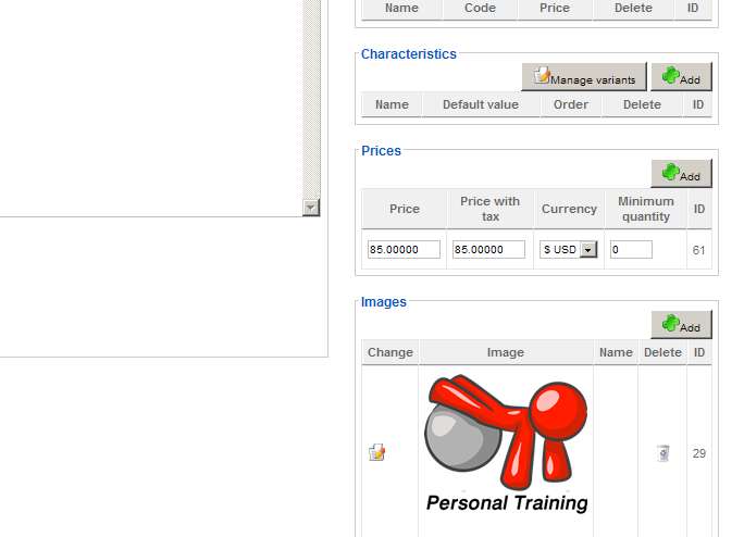

You need to look in the hikashop options of the cart module that you can access via the menu Display->Content modules in hikashop.

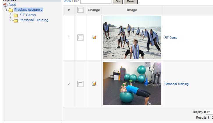

Do you have the images in the products and categories, on the back end ? Could you make a screenshot of that ?
  • Posts: 40

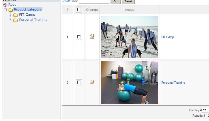

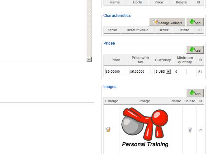

15 years 6 months ago #7793
See attached categories and products screen shots.
These were there before the upgrade and I mentioned I deleted all backend files and reselected all images for both categories and products
  • Posts: 40
15 years 6 months ago #7794
See attached product and category screenshots. These were there before the upgrade. As I mentioned above, I deleted all backend images and re-created all of them

15 years 6 months ago #7797
The images are there so it's not a problem of missing the images themselves but just that they are not displayed.
Could you go in Display->Content menus and Display->Content modules and check that the option "Type of item layout" is set to "title and image" for all of them and save the options each time.

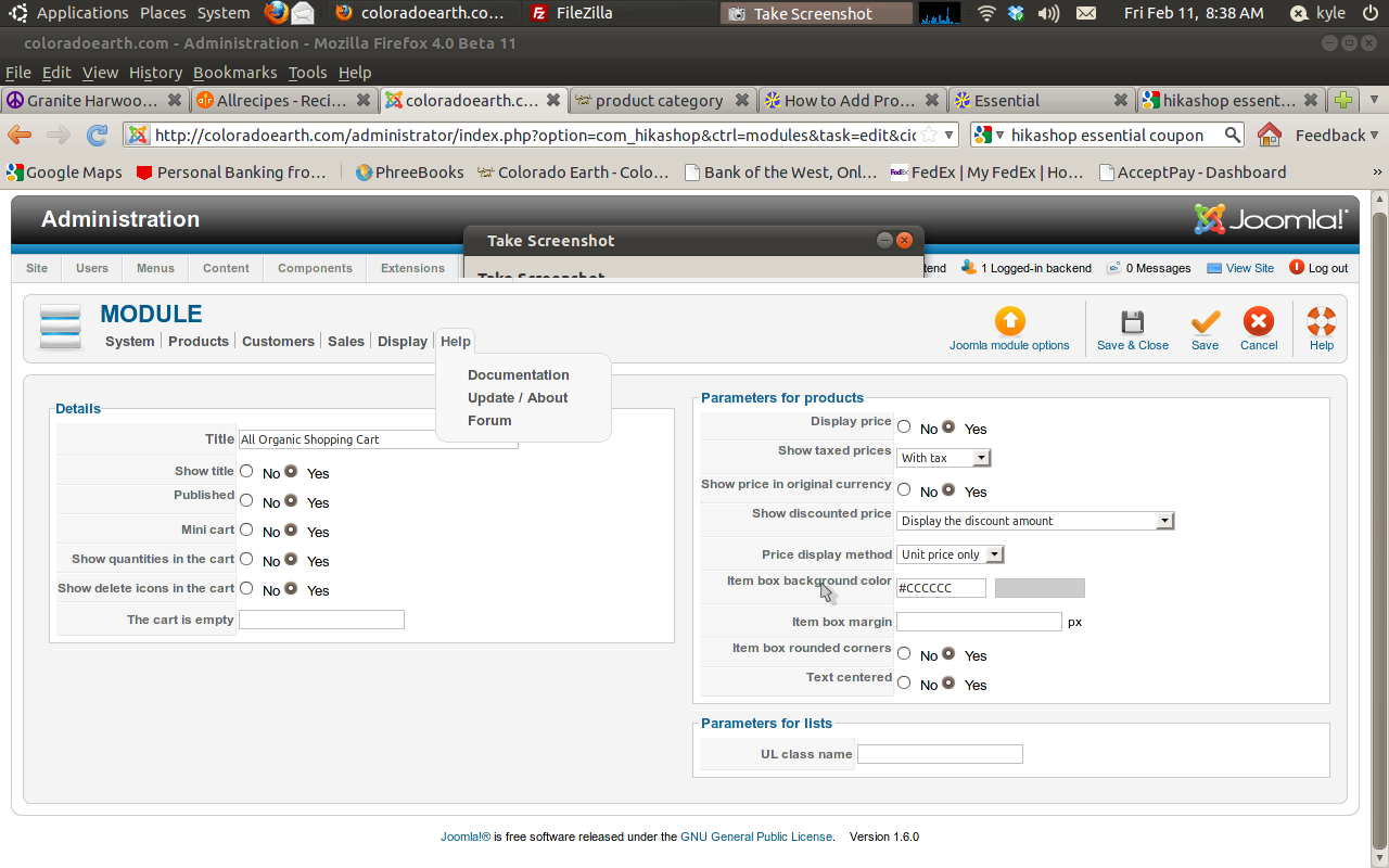

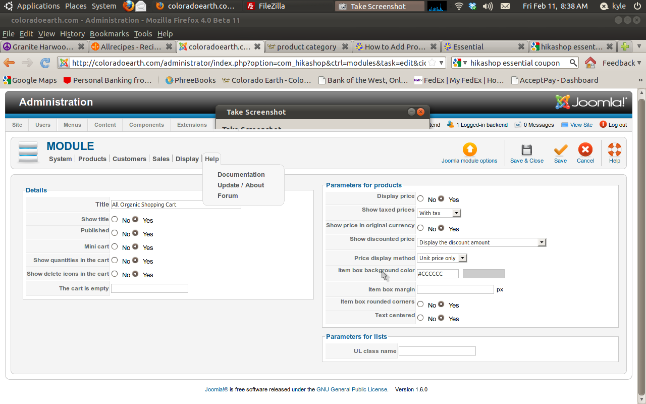

15 years 6 months ago #7801
Here is a screenshot of my content module options. I thought it might have been a new feature or something so I updated about 30 mins ago
  • Posts: 40
15 years 6 months ago #7802
I went into each module and menu and change the option to image applied and then changes to image and title. This made no difference.
I am not sure what you mean by "Did you edit the hikashop cart module in that screen ?" (Sorry). This module is currently disabled and I do not think I am using it anywhere

15 years 6 months ago #7805
There is no proceed to checkout button option for the mini cart. You can deactivate the mini cart option and that will display the proceed to checkout button option.
The question was for the other person...
Then, please go in the configuration and check that the thumbnails option is turned on. If that option is turned off, the thumbnails won't be displayed.
  • Posts: 40
15 years 6 months ago #7809
Where is this option? Would the upgrade have changed this? Prior to the upgrade (earlier this morning) the thumbnails were displaying.
  • Posts: 86042
  • Thank you received: 14175
15 years 6 months ago #7810
In the config under the tab files.
In previous versions of HikaShop, regardless of that option the thumbnails were always displayed.
So we fixed that bug and since you already had that option turned off, when you updated, that fixed the problem and your thumbnails were not displayed anymore.
  • Posts: 40
15 years 6 months ago #7818
Found it... It was turned off.
