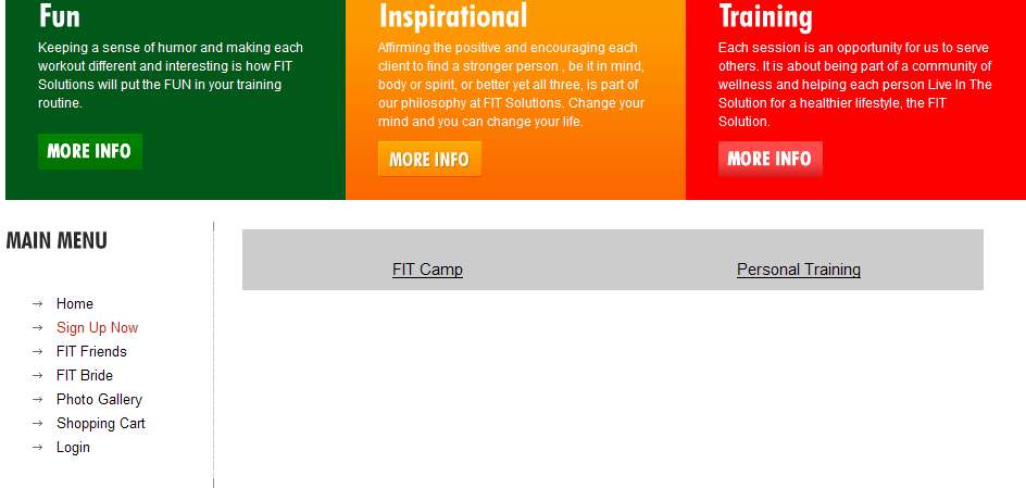

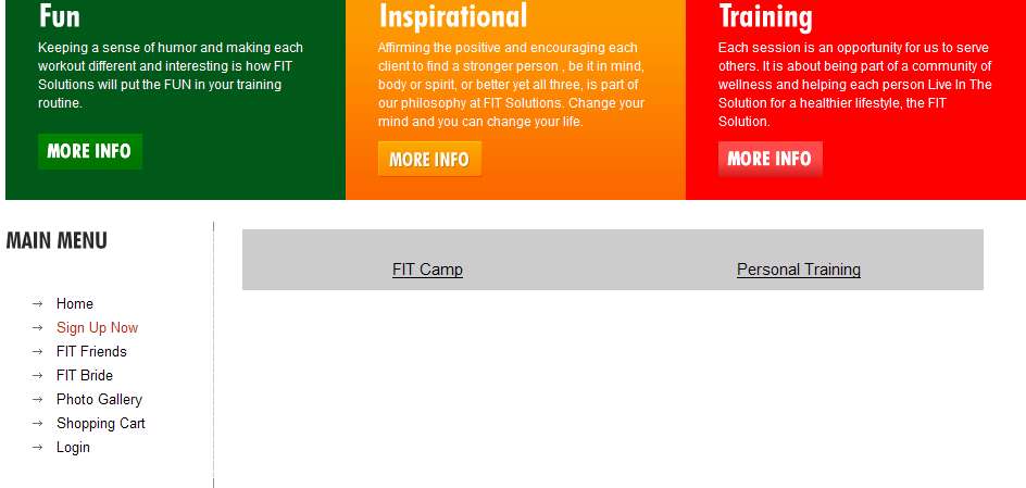

  • Posts: 40
15 years 6 months ago #7786
Using this url
www.fitsolutionsnaples.com/index.php?opt...ut=listing&Itemid=72
prior to the new release the thumbnails would appear above the catgeory name. Now it just has the hyperlink category. No errors are showing
Last edit: 15 years 6 months ago by DShapiroNaples. Reason: Added screenshot
  • Posts: 86042
  • Thank you received: 14175
15 years 6 months ago #7787
That's an option of the menu. If you go in the menu Display->Content menus and edit the menu, you will find the option "Type of item layout". By default, it's "Title and image". Yours must be set at "Title". Change it and save and the images should appear again.

  • Posts: 40
15 years 6 months ago #7789
These are still set to Title and Image. These were set this way before the upgrade
